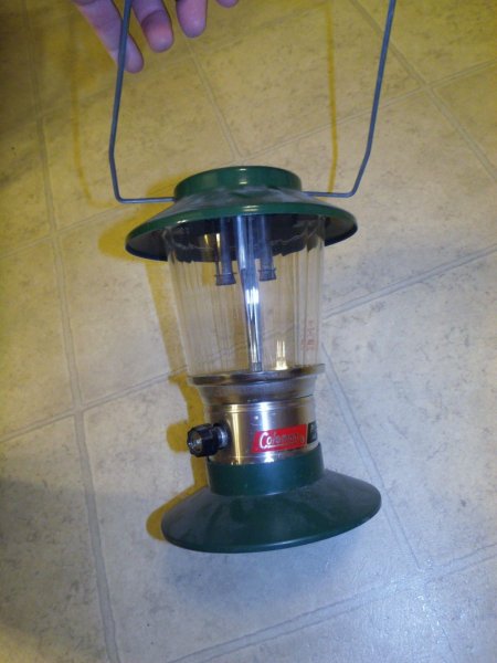

    and here's my recent "big find", yeah, i know it's just a propane lantern, but this one has a story, i've been wanting a 5114 or 5107 propane job for a while now, they're one of the best propane models ever made, and this one popped up on the bay very early this last Monday morning with a very low BIN and low shipping, it said that it may have only been used once then stored and was still in new condition with box, so i jumped on it without really looking that close at it, after an hour or so i went to look closer at it, and to my surprise this one is one of the very few that had the "fluted" style globes in it, the globes are in the 100. range value wise, so once i got it here at home i replaced the globe with a standard "picket" style to use in it and i'll keep the rare globe stored for safe keeping........ s-l1600.jpg s-l1600 (2).jpg

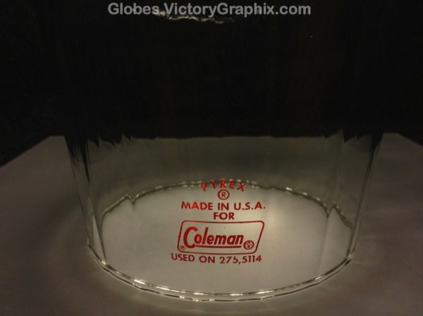

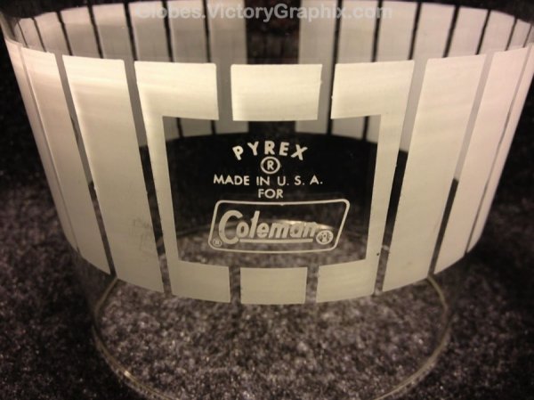

    here's a few pics of the clear fluted style globe and i added a couple of the "white picket" non fluted globe as well, most of these are found on the 275 lantern, the picket style was also made fluted for a short time....... 2461364.jpg 2461366.jpg stacks-image-553F71F.jpg images.jpg

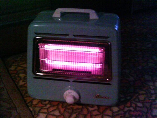

    well, this is a little off topic but i just had to share, i almost bought one of these heaters off ebay a few weeks back but let it go through and someone else bought it for next to nothing, i thought they were much smaller than they really are, the heater is a 60's vintage Arvin in classic teal color with chrome trim, i found this one today at an antique mall priced very reasonably and i grabbed it, still in super shape and works very well, IMAG0041.JPG IMAG0042.JPG it also has a tip over shut down, must have been state of the art back then and it really throws off some heat, it also is fan forced with automatic thermostat, wish i new what i passed up on ebay or i would have bought it, heck, for all i know this might be the one that was listed!!, anyway a couple pics.........

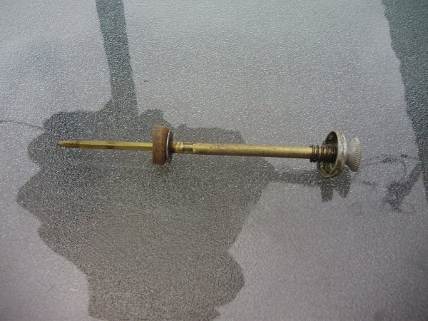

    The disorder is starting to take hold. Picked up a 1-76 Coleman 220J over the weekend. Pics to follow soon. The pump won't build pressure. Looked at the W store and there were pump assemblies with about 17 model numbers starting at 228 and up. Will it work in my 220J or are 220's a different pump? I put a couple drips of oil down the hole 15 minutes ago. If that will help how soon will I know?

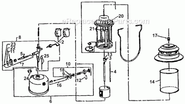

    i'd take out the pump assy and see how the pump leather looks, you may need to replace it, use neatsfoot oil on the leather and fold it back over itself and let it soak in the oil for a while, also spray some carb cleaner down the pump tube and let soak on the check valve down at the bottom (take out the close off stem first), worst case you may need to remove the check valve to clean it (a special removal tool should be used), alot of times they just stick from not being used, also make sure the filler cap seal is good, if dry rotted at all replace it, an o-ring will get you by in a pinch until you can get the right cap seal....

    s-l1600 (8).jpg here's a breakdown of the 220j, the pump leather is item #18, and the check vave/close off stem is #16......... 220J195_WW_1.gif

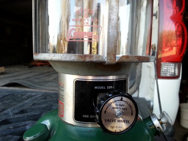

    Just went out to the garage and played. I took pics and tried the pump. I think the pump may have come back to life. I can now build pressure and if I crack the valve I can hear hiss. I will need to clean the fount and try firing up when I have more time. My Akron needs a good cleaning and a filler cap seal before I try the pump. Any lead would be appreciated on finding an accurate glass for the Akron 103.

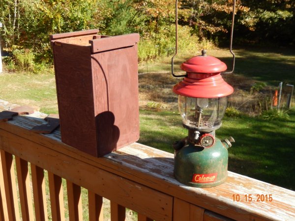

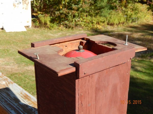

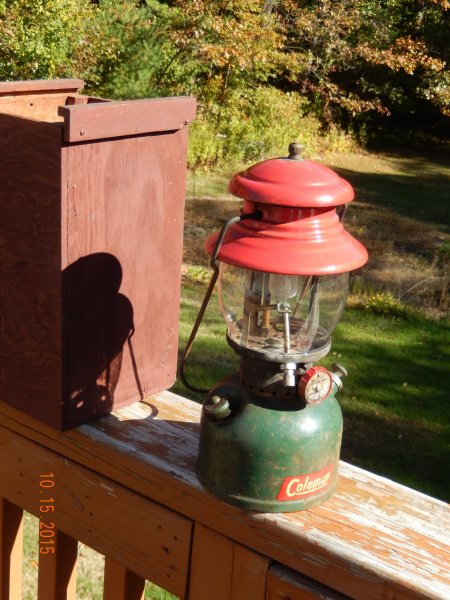

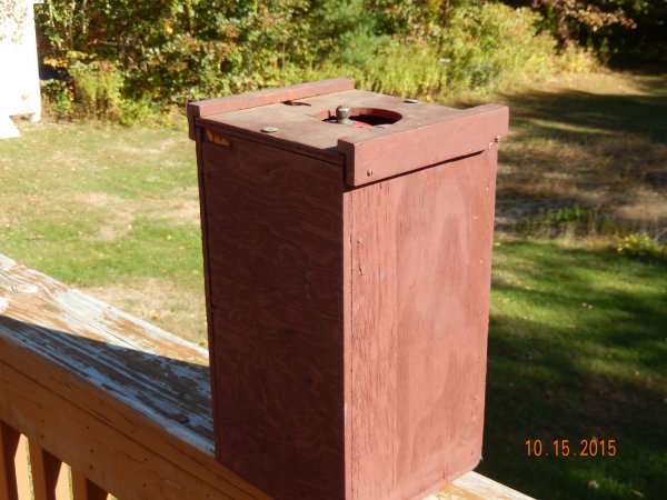

    Dug it out and will take pics, gotta get my kid help me load them when he gets home from school. How bad is that.
  20. NH mountain man
    NH mountain man
    6,408
    37,833
    WMNF N.H.
    OK, just got the kid to help me! Here are the pictures of my lantern.:thumbs:
