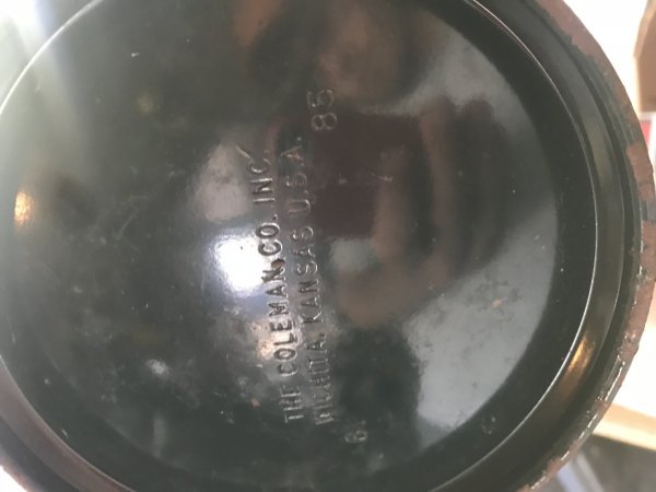

    Coleman fuel, standard mantles both of which are available a lot of places, even the taboo W store. Dump out old fuel if any is left in it, oil the pump, fill er up n give it a try. What is its born on date on the bottom of the tank?

    It had a tiny slosh of fuel in it so I shook it out and pumped her up a bit. Seems to hold good pressure and I can hear it come out accordingly when you turn the control knob. As for the born on date.... 50BDD20D-3D6C-4F98-AC45-881A9E15BA90.jpeg
    6/85 I guess?

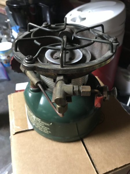

    D88F644B-DB99-4FEF-A4D6-D49EBCE6EDF9.jpeg 98874B15-E14F-4252-B446-A66F4078C0BE.jpeg New toy came today! It’s a 5/68 marked 502 single burner stove. I think the pump seal is smoked but the rest is in good shape so I’m happy especially for under $20! Now I just got to clean it up and figure out how to light it!

    Alright Coleman masters!!! I’ve got a question.... the little single burner stove I posted above has got a serious case of dirty rusty tank! What can I do to remedy this? I also noticed the filler cap has a machine screw through the center of it. Is that supposed to be there?

    Pic of cap? Probably is made that way, but Lord knows what us hillbillies can cobble n fix with what is laying around :emb:. To clean the tank... pop it off, rinse, pour in some red rider bb gun ammo and shake the bejeezes out of it, empty, rinse, reassemble. My bad:picard:. Scrolled up and saw it, yup cap is correct.
