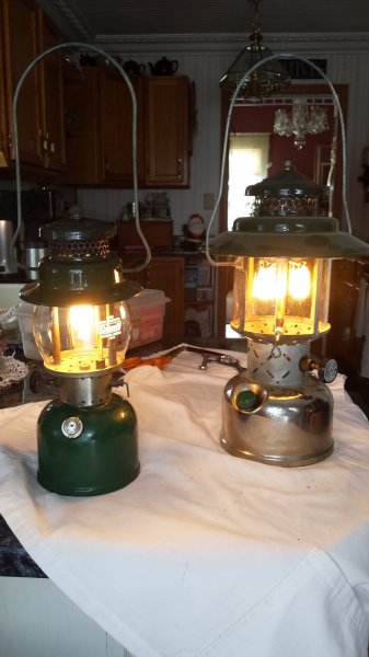

    Farting around with the 242 gave me motorvation to tackle the nickel 228 that I have been meaning to get around to. I now have all my lanterns going with the exception of the Akron. 20161231_115406.jpg 20161231_115548.jpg 20161231_115531.jpg

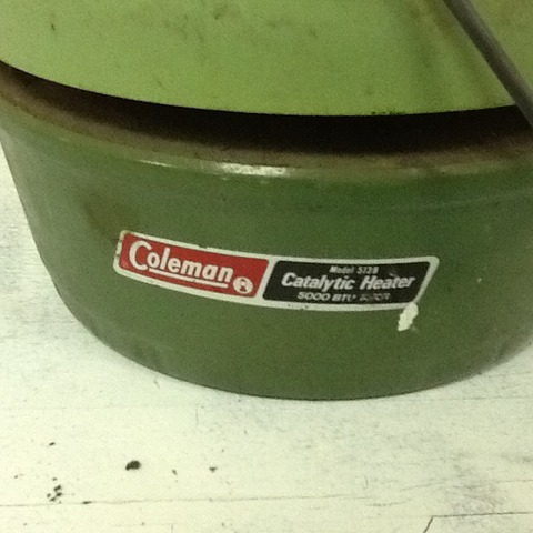

    Ok gentlemen straighten me out as I am confusing myself the more I look into things. I have started to look into a lamp to rebuild. However I am getting mixed information on what it is and what converts. Coleman model 152 that uses a generator T44K. There is no preheat cup and the K designated it as a kerosene lamp. What I have read a 220 lantern generator can be used in the lamp. But is that meant as a kerosene gen or as converted to C-fuel? Also what kind of bracket is used to have a glass shade vs globe?:coffee:
    greendohn and BCPLLC like this.
  10. BCPLLC
    BCPLLC
    Nov 10, 2015
    156
    698
    Henrico, VA

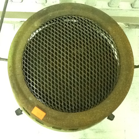

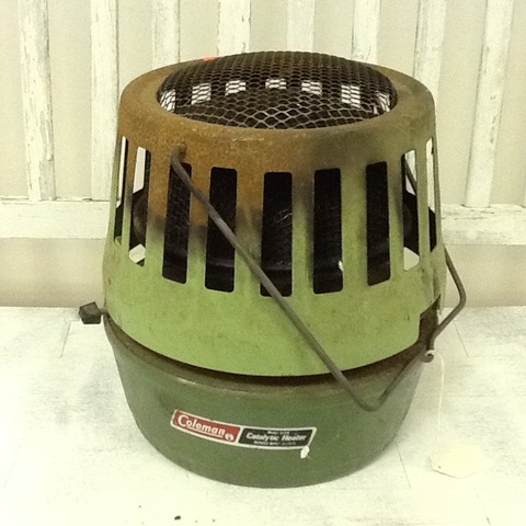

    This guy is currently at the auction house.
    Don't have one. Don't know anything about it, but will be researching, especially if I buy it.
    Don't know if it works.
    Whats the most I should pay?
    I am thinking i gotta be able to get it for 5~10 bucks.
    What do ya think?
  11. Greenstick
    Greenstick
    Oct 4, 2014
    2,400
    12,274
    $10 tops. I have the same one. Mine has only a couple uses on it. I filled it up n let it set about 15 minutes. Poured a splash of coleman fuel on top n lit it outside. After burning down it started to catalytic burn like it is supposed to. Scroll back a few pages and I have pics of my avocado ufo being lit. Page 20

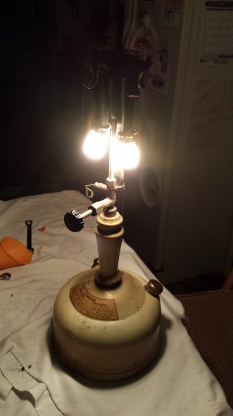

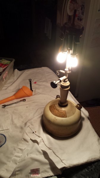

    Dun did sum fartin around and got the old girl to fire up! Now I need to finger out what I want to do for a globe or shade combo and scrub her up. I went CF with a 220 lantern generator and didn't blow up! 20170111_183605.jpg 20170111_183546.jpg 20170111_183533.jpg
  18. greendohn
    greendohn
    Jan 5, 2014
    1,130
    5,644
    S.E. Indiana/Rush County
    If I'm not mistaken,,,the globe from a Northstar lantern will fit that lanter.
    It's kinda' tricky, but you can fit the globe over the metal tabs.
    Greenstick likes this.

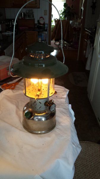

    Haven't ruled out the northstar globe. Found this shade for .54 cents. Its a little small but will work til I find something else. 20170114_141711.jpg 20170114_141659.jpg

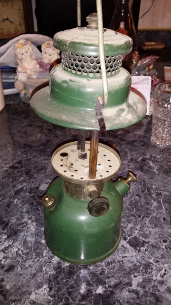

    I have been trying to figure out what lantern my grandparents had in their lake cabin in Mn. I was so young I barely remember it. When they passed away the cabin was sold pretty much as is with things in it included. My aunt had an accidental camera was bumped blurry picture she stumbled across that had an amazingly decipherable collar shot as someone was trying to light it. Some day I want to go back up to Big Sandy Lake by McGregor Mn. However because of that pic I have now got a copy cat of the lantern same model number and letter. If I could only find the date or the original lantern would be gold to me. But here are pics of my copy cat I just found.
