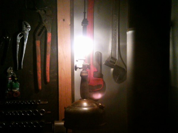

    I think this pic of one of four Quick-Lites I recently added looks pretty cool......:) IMAG0273.JPG
