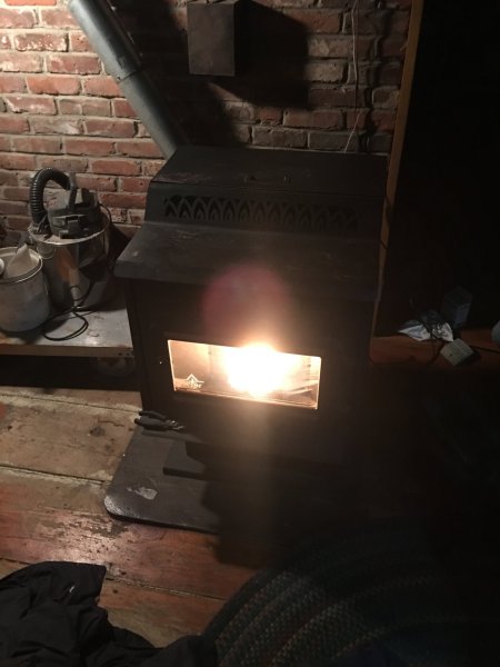

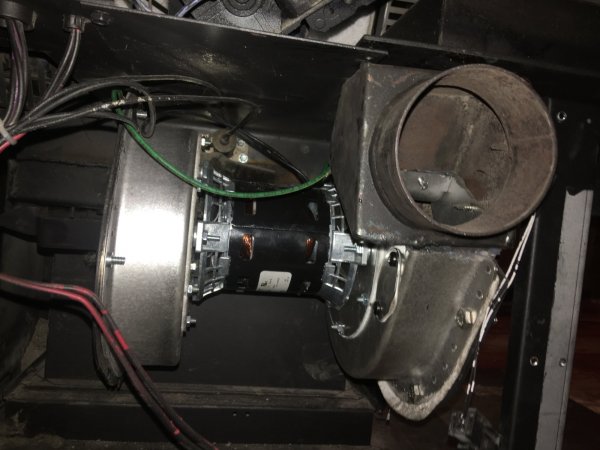

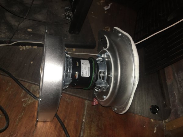

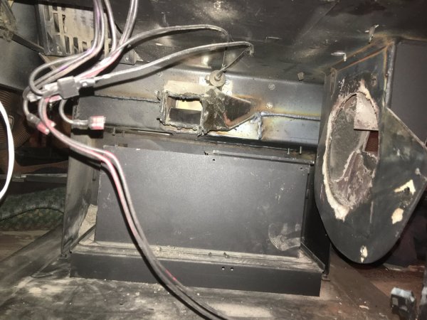

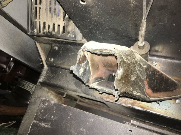

Hello The 2 screws behind the exhaust blower cleanout cover in the exhaust plenum were the easiest ones to remove!! Last pic shows all done!

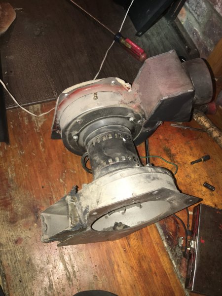

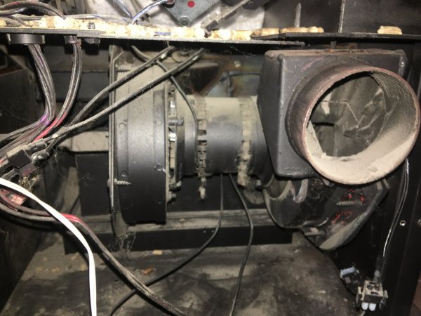

No Not like a Whitfield Cascade, the SBI Convection fans are 2 small computer type AC fans. This one big Boy motor runs this Flame Energy FP-45 positive draft blower and the negative draft blower so if the door gasket leaks no problem!!
Don,you are outdoing yourself this winter.Your pictures are great.Never did a stove like that.Keep up the good work,and the great pictures.
