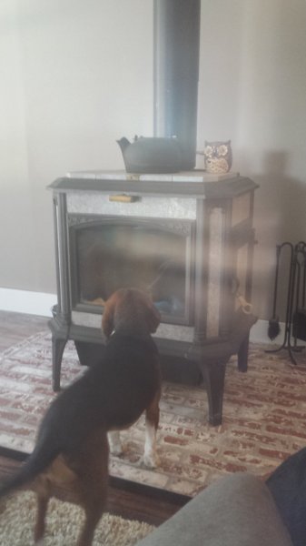

    Here's a couple more photos of the dogs enjoying the stove.

    I bet it gets "warm" in there!! ;)

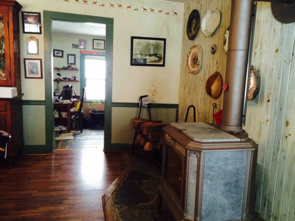

    Here are some photos that should give an idea of the stove room and the rooms that we want to send heat into. I should add that all our windows are going to be replaced this year, which should help the heating situation, but we still have a house about 175 yrs old with little or no insulation.

    Just read your long post, Sherwood. Guess we're being real wimps--we thought we had to cool the stove in order to check and remove cat!!! You did this all with a hot stove?? You've given us a role model--we'll see if we can have the courage to do all that with a hot stove!! Wow!
