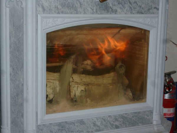

    The light gray PH:

    A bit dark....

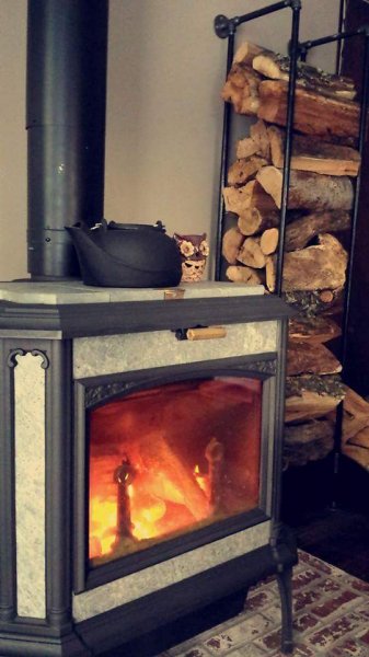

    Here's a couple photos of my PH with my newly installed firewood rack made of black pipe. I'm heating an almost completely uninsulated 115 year old farmhouse that's about 1700 Sq ft. The PH will heat the stove room nicely to 70 - 80 degrees and the rest of the house will sit in the high 60s to low 70s. I'm definitely investing in some blow in insulation this year to hold in the heat generated by this stove. It's pretty comfortable for me as is with no insulation in the house however my soon to be wife is always cold even if it's 78 degrees in here. However she has stated that the PH is, by far, her favorite addition to the house. During warmer 30 to 40 degree weather the PH almost cooks us out of the house. She gets real worried when I do all cat burns where the firebox is dark because she still can't believe the stove is producing a lot of heat even without active flames. She tells me often that I need to restart the fire because it went out. She's too used to the smoke dragon we used to use in the basement which needs a raging fire that's almost constantly in need of more wood every 2 hours compared to the PH which is reloaded 2 or 3 times a day. Yesterday I came home late to a cold stove and a 48 degree house and the PH warmed it up to 70 in just over an hour and a half after I restarted it. That's pretty nice for a heat source that costs me nothing to run.
