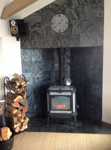

  14. Machria
    Machria
    2,435
    5,027
    Long Island, NY
    And here is a pic from just now.... Hard to beat when you throw in that that 750lb piece of soapstone art is also heating my house!!!
    milleo, splitoak and concretegrazer like this.

    Me too on both counts! The Progress is a great stove.
    Is that a speaker directly behind your stove?
    Sorry to hear about the cooper, that stinks. It just ain't right at 65K for a motor to blow - bad oil pump or what??

    Behind? Not sure what your looking at? Maybe the fan on the right side which is spinning?
    The only speaker in pic is at the top left of pic, wall mounted.
