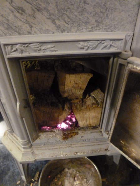

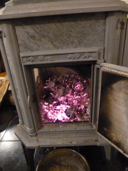

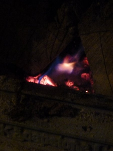

    3:06, ash removed, s P1050799.JPG [/ATTACH] P1050803.JPG tove loaded, and flame on the front lower split before the door is closed. Four splits of sugar, three 5x5 x18 in, one 6x5x18. Flames roaring now, two minutes later, going to close the flue damper. Have already closed the air by 1/4.

    The previous post picture of the coals was taken before the coals were burned down. Second shows flame on reload before door is shut. These pictures show coals at reload, and the load. P1050800.JPG P1050801.JPG

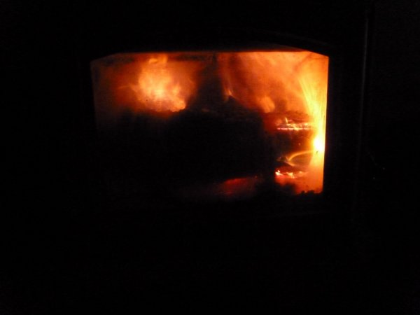

    3:30, stovetop 300, probe flue thermometer 540. Closed air to 1/4, closed bypass to engage cat. P1050805.JPG
    Going to bed! May get one more picture before. Anyway, half an hour from a really small coal bed, and me wasting time fiddling with the postings, and the stove is settled down for the long burn. I'll just shut the air all the way now.
