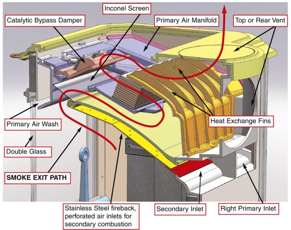

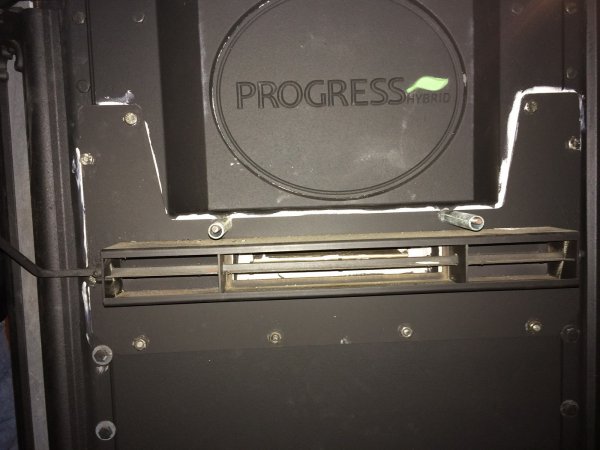

    A few weeks ago, I had the gasket around the secondary air intake blow out. That is the middle air intake as shown in the pic below. I had to remove that air intake panel (shown in white in the pic), and replace the gasket around the center intake. I noticed the 2 side intakes (I have marked primary air intakes) go to the sides of the stove, and then disappear. From the 2nd pic from Woodstock showing the internal workings of the PH, those feed the glass airwash and the center hole in the front (although I have yet to figure out how the air gets to that hole?). The center (secondary air intake) feeds the secondary baffle plate and when you close the air control knob completely, that section is completely 99% closed for the most part. The 2 primary air intakes however stay open just a crack, even when the air is shut completely down. This is done by a simple rod going all the way thru the middle of all 3 intakes, and attached to this rod is 3 "blades" (1 for each intake opening) which turns with the rod and closes or opens the intake opening when the handle/rod is rotated. The two primary "blades" are slightly angled a few degree's off so when the center one is closed and can't be moved any futher, they are left slightly open. Interesting design.
    What I would love to talk to Woodstock about is doing is, redesigning that control mechanism. OR better yet, just offering a 2nd more expensive option for it. This design would make this a bit more mechanical, or geared for lack of a better word. They could make the control handle instead of rotating the rod directly, rotate a gear or two which would then be connected to the rod. This would give you more movement and control at say the last 20% of it (as requested above via the IS control). They could also add in detents (10 or 20 detents or clicks) so you know which "setting" you are on. You could then tell the wife, "close it completely and then go up 5 clicks" for example. I would have no problem paying a decent amount for this "upgrade" option, and suspect others would as well. What do you guys think?
    It would be a easy thing to design and make, and it would be very easy for anyone to install. You just remove the 8 bolts, pull the existing "control panel" off, spread on some stove cement and bolt the new one on. It would take anyone 10 minutes.

    Those holes are actually the primary air, not the secondary air. The secondary air only comes out of the holes lining the top of the stove (the stainless baffle which acts like "burn tubes"). Maybe that was just a typo on your part?? Anyway, check out the pics I posted from Woodstock of the PH cutaway....

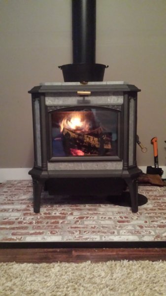

    20150107_080949.jpg Got the new stove up to 520 this morning after getting it installed and broke in yesterday. It's currently 5 degrees, snowing hard, with 30 mph winds here in Western Michigan.
