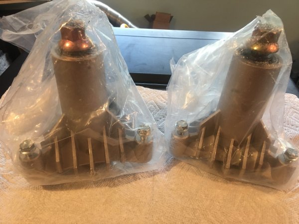

    It shouldn’t matter if the bolts break you have new ones in the splndles. It might even make things easier if the bolts break. I was concerned about the same thing when I replaced mine but realized I was overthinking things.

    It went easier than I had expected if you have and impact gun you will be good to go. Takes longer to get the deck off than to swap the spindles.

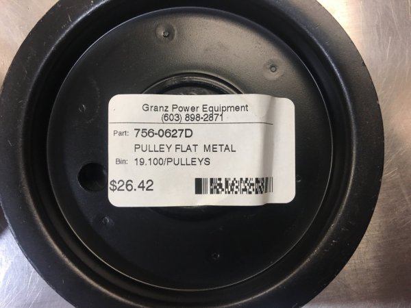

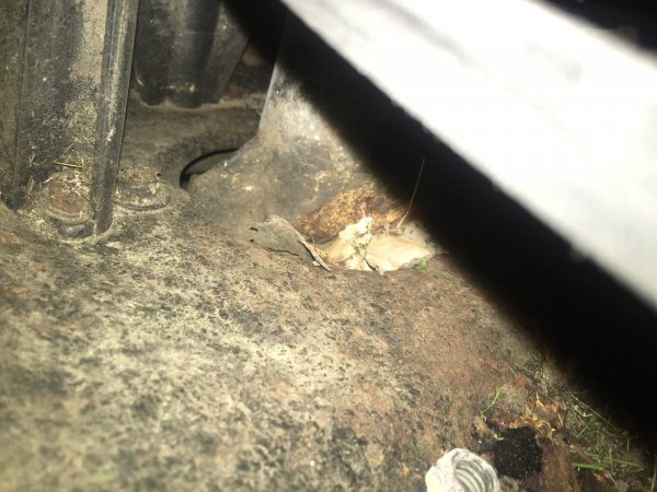

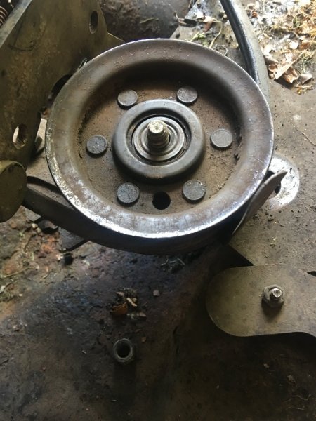

    Well, I dropped the mower deck and pulled it out and I was very surprised at what I found! It is was not I problem with one of the spindles at all! At first I noticed the Nut came off of the left pulley! Luckily it just fell on the deck and was sitting right there!

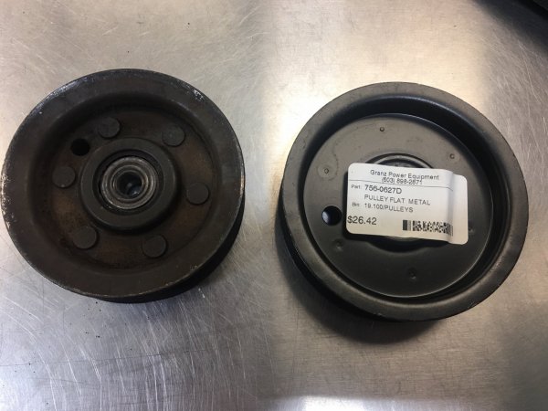

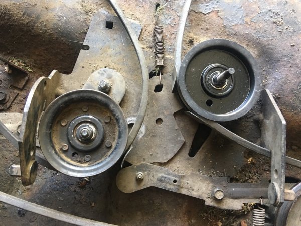

    The pulley was really tilted so I removed it and found that small bearing in the pulley was completely seized! So I went to the Turf Depot formally Grantz and they found a new pulley that was almost the same size as the one I had that broke, just a smigin bigger in diameter. Sure enough it did not fit due The the hold up bar that mounts the mower deck to the tractor being extremely close! Luckily the other pulley that was still working is the best cactus same size with more room around it! That gave me an idea !!! So I swapped the pulleys and the new one fit! Bingo! All fixed for $18.00 buckos!!!
    Pic 1 - Nut fell off pulley onto mower deck.
    Pic 2-3 - slightly larger new pulley
    Pic 4 - All fixed with new pulley swapped with working Old pulley and old pulley replacing broken pulley. Tractor is working again. :)
