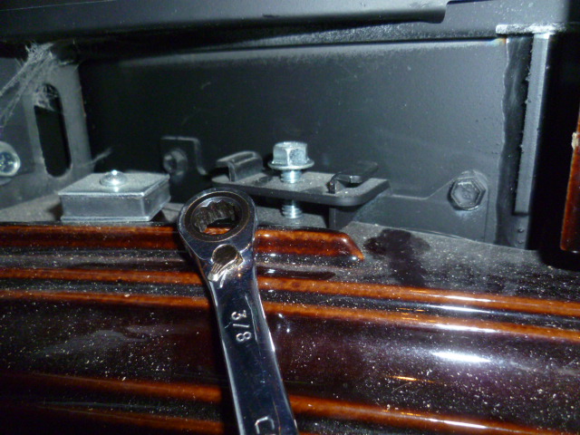

    They make getting into the fines box simple in their video. At about seven minutes into this:
    Even though that video is supposed to be for the insert version, I wonder if they substituted the non-insert version footage or something, because there's no way ours look like that.
    Here's another video, but this one is for the P35. Looks like they used the exact same footage for both:

    Oh yeah. I have looked at all those videos and think I have read almost every article including Harman's own. There is very little I suspect because they don't want the average Joe to work on it. I believe they want to encourage professional cleaning... much the same way these new cars work.

    yea, not all that bad....you DONT need to remove those screws unless you are replacing the combustion fan. But, yea, a bit of a pain when you have to do that. Much easier to disconnect the wires, pull out the stove, and lie it down on its face.....
    imacman and ivanhoe like this.
  10. Lousyweather
    Lousyweather
    Dec 23, 2013
    2,798
    9,040
    take those "jack bolts" out.....throw them away. They will mar that Majolica finish

    So I bought a nice rail kit and got ripped off. Very unlikely I am going to remove the stove and flip it over. So i think the best plan here is to call in my wife and have her use her smaller hands and remove the plate. If not, have you ever removed the combustion motor from the side like I am suggesting? I think MAYBE it could be done with patience and struggle. Might even be able to put it back too. :)

    Without moving the motor out of the way, it could be tricky getting the vacuum in there.

    Thanks! Not to worry though. They are just barely snug. Just tight enough to keep the casting from rocking on the uneven brick surface.

    yup....the one on the side is easy....the other two? not so much.....
