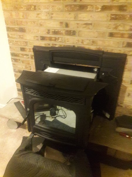

    I'll send pics shortly. I don't understand it.

    I suspect I have to remove the bolt in the far left in this photo and the bolt in the far right (hidden in the shadow). It appears this is where the ash lip is being held down or connected to the frame. What bothers me is that these screws/nuts show no signs of wrenching. That tells me that a) the lip was never removed during installation or b) the lip is secured elsewhere.

    I can remove them and try but it's a nice paint job and I was hoping not to eff it up if it can be avoided -- particularly if it's not the correct solution.

    I'm pretty sure my problem is with either the orange or red bolts on each side. Anybody have any feedback?

    I just looked at the installation manual -- and while they didn't say anything specifically about removing those red screws -- their diagrams don't show this red screw. Furthermore, the ones I have circled in orange are called Tek adjustment screws and appear to be used for door alignments.
    I checked the screw in red and it doesn't appear to be hex so I'm most likely going to try channel locks. But I could use some confirmation. Do any of the 52i owners have this screw in red and if so, have you been successful in removing the ash lip?

    Is it possible the screw in red was a shipping bolt that was supposed to be removed before final installation? It looks like the removal of that might allow the top portion to move (slide). It doesn't have a screwdriver slot in the end, does it?

    I agree. I'm not sure what function it's serving otherwise. I guess I'll try some channel locks and see what happens. It'd suck though if I ruined the threads on that screw and found out later I was barking up the wrong tree and really needed those.

    Just confirmed with a guy in another forum that these red screws are unneeded and can and will be removed

    If you haver 2 nuts the same size & thread, wind them down a little and lock against each other tightly, then try turning out.

    You don't have to do anything the orange screws. In theory, just loosen the red ones and that trim should slide out the front.
    Those red screws look weird to me though... Do they have heads on them? Mine are bolts with hex heads. I can take a pic if you want?

    Yeah took the red screws out and it came right out.

    I got the ash lip out, the stove pulled out and cleaned the exhaust tube again from the inside and vacuumed from the outside.
