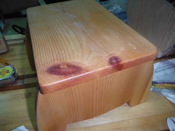

    I used to make these stools by drilling, screwing & then make wooden plugs to cover over the screws.
    8 plugs per stool, 4 in the top & 2 on each end.

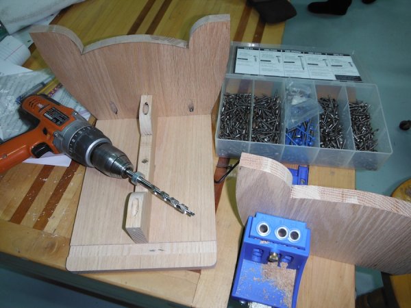

    Making a couple G-kids Christmas presents
    tonight & trying the kreg jig.
    Drill batteries died before I finished the first one but working well.
    Fitting it up, then sand ,then glue
    Anyway, some kreg jig pocket hole screw joint pictures :
    Jig, bit, pocket hole screws, some WV read oak from Dad's saw mill.

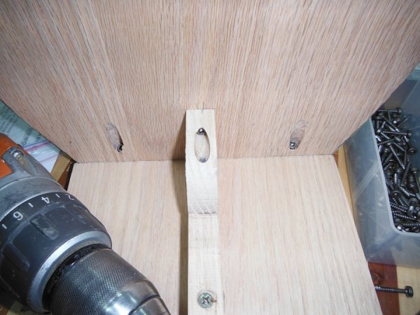

    Close up of the screw in the pocket holes :
    Fine tread ones for good hardwood.
    Will finish tomorrow glueing & screwing them
    then work on the coating.
    Red oak take a lot extra finish work
    Porous wood, keep soaking in varnish for several coats. (same when rained on, water goes in deep, long tome to dry )
    Have had glue come out of the pores several inches from glue joints.
    I have some wood finish sealer that works pretty good, but red oak takes 2 or 3 coast of that.
    White oak much better, & tougher IMO.
