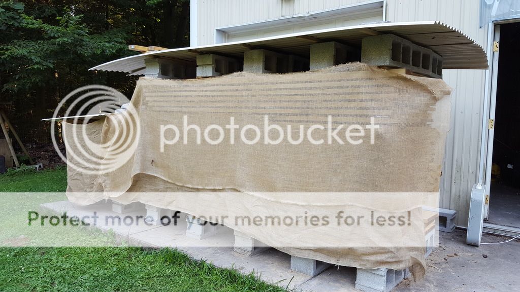

    My neighbor took down a nice tree recently, and from it I have six hard-won slabs about 7' long, 2' wide and 2 1/4"" thick. They're very heavy, and I found four different steel hooks along the way, so I'd rather not waste the ruined chain and all the effort. Does anyone here have experience drying white oak, in particular?
    Currently it's stacked on my deck with poplar stickers, an OSB roof overhanging 6" all around and three coats of paint on the ends. It's on northeast corner of the house and gets only a smidgen of sun each morning, but it's right in the path of the prevailing winds.
    Last year, in late summer, I cut several similar slabs of honeylocust and dried them on the other side of the deck, with fewer coats of paint on the ends, a smaller overhang on the roof, and more sun. I got a good amount of usable lumber from those, but there were more checks and cracks than I hoped for. I'd like to do better this time.

    White oak is very tough to dry without some defects. Event the "experts" can have trouble, so don't blame yourself if you get less than perfect results. I think you have a good start with shade, airflow and covering from rain. You might try to put some stickers out at the very ends of the boards. Also, you should consider putting some weight on top, at least on the ends and the middle. I have been very successful with putting a row of cinder blocks over the stickers. As above, I tend to rip the pith out. It's going to crack or be a major weakness anyway. But it's not the end of the world to leave it in during drying and rip it out later.

    The wood has been stacked about a week and a half at this point, and I'm already seeing a lot of shallow surface checks on the top two boards. We're having a warm spell, too, which of course won't help. Clearly the wood surface is drying too quickly, but I don't have any great ideas for slowing it down, short of painting entire planks...

    You can try wrapping the stack in burlap (available cheap at any big box) to decrease the breeze and sunlight.
    You don't want it touching the wood, just draped a couple inches away. Again, white oak is one of the very hardest native woods to dry, so expect some degrade.

    The burlap looks like a good idea. I read about some commercial products that do the same sort of job, but I suspect they're hard to get in small quantities. For the moment I've placed a piece of plywood as a temporary wall on the windward side of the stack, to reduce air flow.

    I would wrap it with landscape fabric maybe even a tarp until the weather improves. It looks like you have a bunch of airflow even from underneath.
    I'll saw several logs, do this and that get busy pack up and not have time to move them to a good drying spot for sometimes a week or two. The lumber closest to the ground is the unaffected by this. As I go up the stack more defects are obvious because they dry too fast even in the shade covered with a tarp. A tarp can screw you as it won't let enough moisture out and mold.
    I always always advise low and slow especially on slabs. On most species the initial drying is the hardest on it. (Right now for you)

    I wrapped it in some spun nylon fabric that my friend offered. It's similar to landscape fabric except it's white, which might help a bit by reflecting more sunlight. Considering a tarp, too. Thanks for the advice.
