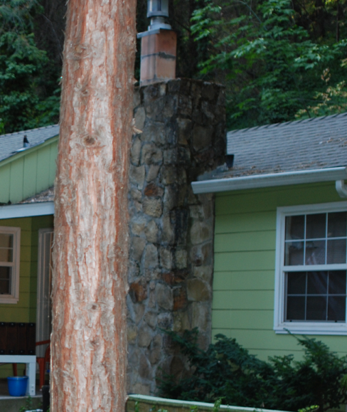

    I'll get some specific information about the flue this afternoon(maybe pics will help). But looking at the manual, it is calling for minimum of 3 foot from the roof exit. The 2 foot I was quoting was CA code for minimum height above nearest roof line within 10 feet. I did not find a minimum lining length.
    NOTE: House was constructed in mid 40s and had some sort of update in mid 50s. There is nothing to make me doubt that the fireplace is that old.

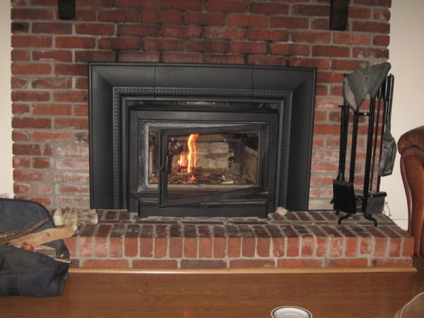

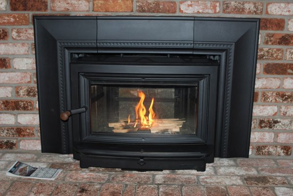

    A couple of pictures to help.

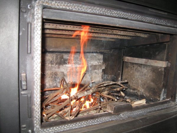

    Here is start of break in fire:
    Here is old chimney before reword(propane insert):
    No, the tree is not next to the chimney. ~15 feet away across a creek:D

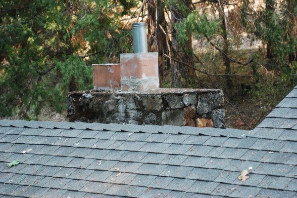

    Here is chimney with new insert from the backside of the house:
    On top of the tubing is a "trap". The piece of terra cotta off to the side was not remounted(may be causing issue with proper draft)

  4. papadave
    The minimum flue height for that stove is 13'. Looks like you've got that covered.

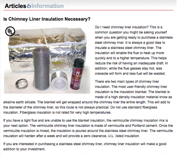

    Is the liner insulated? Is that terra cotta capped in any way? Hard to tell from here.:D
    What the heck is a "trap"?

    Might be worth asking your installer if he had to comply with some special spark arrestor code based on where you live. If by "trap" you are referring to a smaller opening spark arrestor, that could decrease the flow of smoke/air out of your chimney. Here's a little info on the "California chimney cap"

    When you say "is the liner insulated", what do you mean?
    The terra cotta did get capped with flashing. I forgot to take a picture of the finished product :(
    The top of the liner is also capped with a spark arrestor.
    I blame lack of proper coffee intake for saying "trap". It should have said capped... and the better term is a spark arrestor similar to the middle picture. I'll see about getting a better picture of the top of the chimney if I'm not getting sprinkled on :)

  8. stuckinthemuck
    stuckinthemuck
    3,247
    15,354
    Couple different ways of doing it.
    1. Double or triple walled pipe.. (much more expensive and usually for an exterior chimney)
    2. Wrap around insulation kit that goes around a flexible liner.
    3. Non flammable insulation dumped down the chimney between the terra cotta and the chimney liner. It is stopped by a block off plate in the vicinity of the smoke shelf.
    http://www.rockfordchimneysupply.com/articles.php?article=Is_Chimney_Liner_Insulation_Necessary

    In looking at the invoice, it used right at 13' worth of tubing. It appears to be 6" diameter. My quick tape pull on the stone portion of the chimney does look correct(~9 to 10 foot from top of stone to about where the top of the wood insert wood be) So if I guestimate that the terra cotta is ~12" to 18", I'd say that from the top of the stone adds another ~3 foot.
    I do not see a manufacturer for the part number called out explicitly but it cross references with DuraLiner(invoice showed two of 6DLR-48 and one 6DLR-60F). When I go to a site, it claims 1/2" insulation blanket on straight tube:
    http://www.northlineexpress.com/6-x-48-duraliner-round-rigid-chimney-relining-pipe-6dlr-48-6054.html
    http://www.northlineexpress.com/6-x-60-duraliner-round-flex-chimney-relining-pipe-6dlr-60f-6057.html
    The 5 foot flex does cause a +/- to the overall length.
    The cap is this guy:
    http://www.northlineexpress.com/6-d...dlr-kxc18-6071.html?fee=7&fep=6071&2Bshopping
    I don't know how tall a typical terra cotta piece is but it could get a second piece on top as it was originally done with the propane insert.

    Hey Lil'John you got a nice looking stove;)
    Sounds like you're experiencing some draft issues with the delta in temperatures being so low (we discussed this in your post back when looking for a stove)
    There's a lot of air space in the Clydesdale and when I have moderate afternoon temps outside I'd get a bit of extra smoke on a cold start.

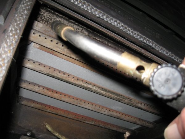

    Invest in a propane torch [​IMG]Not only are they handy for other projects around the house, you can run the torch back and forth across the front upper exhaust exit to "create" an artificial draft.

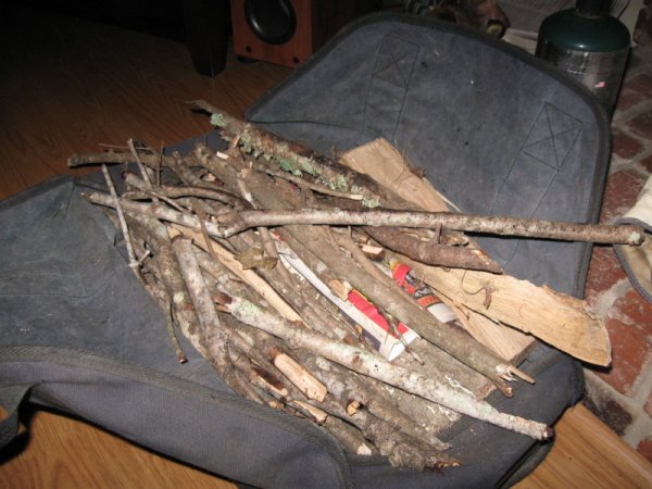

    You have plenty of woods around your house, start collecting kindling from fallen branches. I use two halves of a poly 55gal drum(cut with a jigsaw and tied rope handles to move around) As I'm breaking up branches one half gets little stuff twigs up to 1/2" the other gets limbs that I can break across my knee or on a nearby tree. You could use a couple 5 gallon buckets, I just like being able to step down on the brush and fit more in my homemade totes.
    Make sure the air handle is pulled all the way open (forward)
    Use 4-5 balls of newspaper, two handfuls of small twigs, and 4-5 pieces of larger limbs. Run the torch back and forth across the upper edge and then light the newspaper in several locations.
    Leave the door wide open on warmer days and gradually move it closer to shut(unless you have billowing smoke), while the fire is getting established add some smaller splits of your oak(preferably the outside re-splits) If the oak does not appear to catching on fire in this time frame - you have wood moisture issues(only time will solve that). Add a few more of the larger limb pieces and close the door.
    Once the blower kicks on start trimmimg the air in slowly(1/4") and wait 5mins - you'll see air forcing on the front section of the fire.
    If you start throwing big pieces of oak on at that point(that aren't dry) your fire will die out.
    Kindling will be your friend - collect lots of it, untreated building scraps work great as well, split dead dry pine small and use that as a starter

    But I'll ask the dumb question: when you say "across the front upper exhaust exit", where are you talking about? Inside the insert toward the top front edge?

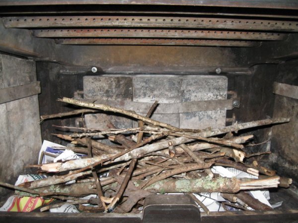

    Since it's a bit cool here(56 outside 71 inside) I decided to start my first fire of the season:thumbs: Just to get a few pics to help you out
    bag of maple limbs from the yard - it rained night before last ~2" so stuff is a little damp
    Stacked up ready for fire
    This is the area you want to heat - I don't stick the torch directly up in there, hold it back 4-5" and move back and forth briskly
    ~2mins in
    sitting on the couch reveling in my pyromania:drunk:, added a dry maple split and the rest of the kindling on top of it, chocked the air down a bit and the blower just kicked on
    Open the door slowly if you add any wood (crack door 1" let the draft pull the smoke then slowly open further)

    here's the split starting and now just easing it along real slow - blower as slow as it can go(burning the dust off early season smell)

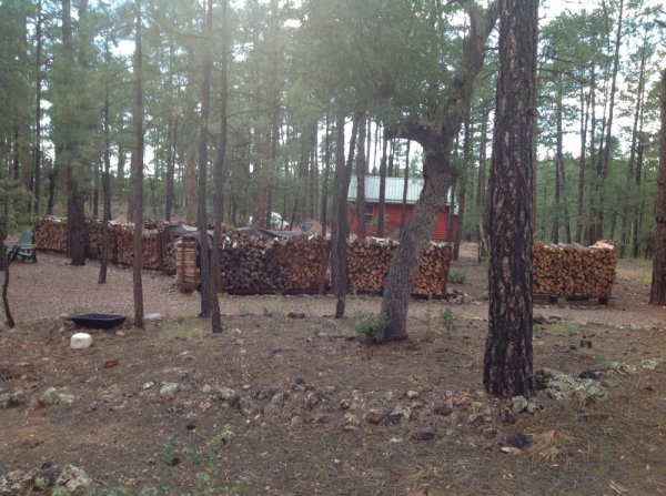

    I can definitely vouch for scrounging dead and downed from your National Forest. I border the Tonto NF in northern AZ , and that's where this wood comes from. Just to be safe I split it right away and let it dry for a year prior to burning, but I could burn right away if I needed to.

    trooper, VERY nice. Unfortunately, right now I'm cord storage deficient :( I'm looking into creative methods to store wood on my lot: 1/3 acre most of it uphill:emb:
