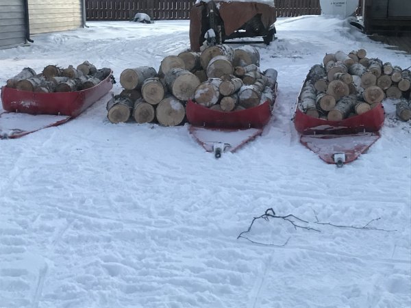

    So , I have a 99 550 Panther that I will be firewood hoarding with .
    My goal is 128 cu ft ( cord ) sled loads.
    My track is in very good shape . But doesn't have boat loads of traction on hard pack or ice.
    For big loads I will have to freeze down a strong skid trail for the snogo and sled.
    Sled is 11' long x 3' wide with lots of side stakes.
    There used to be a product called Cat Claws that you could bolt to the track. But I can't find those anywhere.
    So I am thinking to use bolt through Ice Picks.
    Anyone have any experience with these or know where I can get them.
    Any recommendations on where to put them on the track or how many to use.
    This snogo goes at least twice as fast as I need or want it to go so I'm not worried about a lot of steel in the track slowing me down.
    Sorry but it's the best pic I have on this phone at the moment.

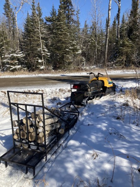

    I hoard with a snowmobile as well. You gave me some ideas for my outfit Cold Trigger Finger. My machines are one lingers so I could build a sled like yours, just a bit smaller, but bigger than the metal one I have, which is designed to pull gear and another person for ice fishing. The tracks on both my Tundras are original and look really good for their age, and considering how much I have used them.

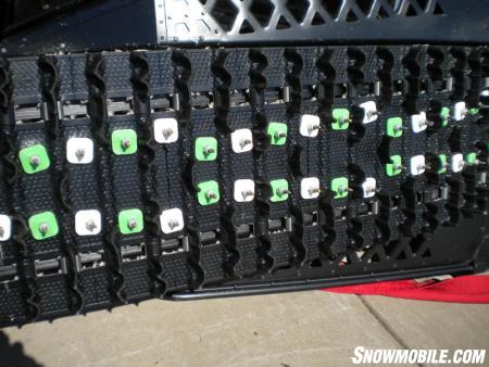

  5. Horkn
    27,062
    151,116
    I'm very familiar with the sled you have. My buddy had a 2000 550 panther. Same sled.
    I have studded all of our sleds. I'll continue to do so unless I buy a sled with a pre studded track. Corners for trails get icy, as well as hills. Sliding in reverse with barely any control isn't fun.
    Our 97 Yamaha venture 600 is a good comparison to your sled. 136" track, factory 2up under 100hp. 96 hp on the 600 venture and 85hp iirc for that 550 Suzuki.
    You have a 136" track, from what it appears. That was the stock length. If so 2 studs per lug will easily give you the traction you require when it gets icy. That would be 108 studs. You'll need to measure the lug height to know how long of studs you'll need.
    Cat claws didn't hold up, but they also rode in the steel lugs that also were the clips in the track that the hyfax ride on, on slide rail sleds.

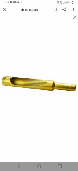

    To drill the hole, you can use a drill driver, but you'll need a track bit that is made for this. It's hollow, and the plug you cut out goes in the center. As you drill more, the plugs fall out of the bit. Screenshot_20211203-143344.png
    You'll need a template, which you can make. Do them in a V. Start wider and and the track rotates forward, then go narrower.
    Like this.. don't put studs in the outer lugs just the center. Track-Studding-18.jpg
    "Track Studding the Right Way - Snowmobile.com" https://www.snowmobile.com/how-to/track-studding-the-right-way-1305.html

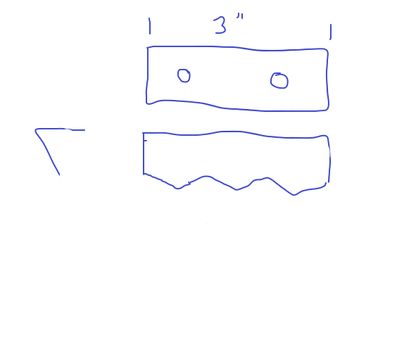

    What did those kangaroo kickers look like / made of.
    I was thinking of steel paddles in the center and ice pics on the outside edges of the track.

    I don't remember exactly, but they were stamped steel and plated with a jagged edge at the bottom to assist on hard pack or ice. They were like paddles that were angled some towards the back. I remeber them as very aggressive and were very good in the deeper snow. I'm pretty sure I had gotten them at the Scropion dealer in Mansfield (long gone) but they were not a Scorpion product. I bolted them on myself. I remember when I traded it in a few years later at the small dealer in Chatfield, OH (a guy I went to school with) said "wow, that's a lot of stuff on there, no wonder it is stretched." The all rubber track couldn't handle it especially when spinning and gripping all of a sudden. I rode it like a wildman back then... LOL

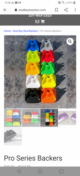

    Just thought of this. Stud boy brand has special backers ( washers essentially) that have extra paddles built in. Add this to the penetration of the carbide studs and this should help you.

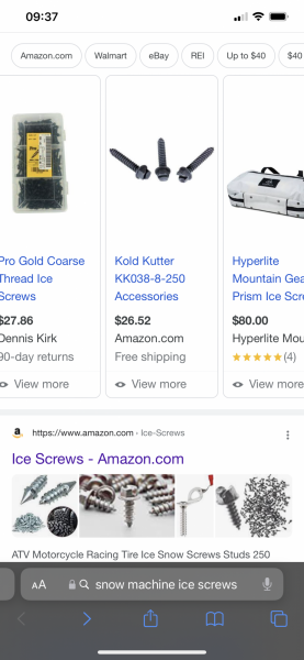

  19. Rope
    Rope
    Oct 16, 2017
    5,356
    30,824
    Alaska
    These are ice screws that screw into the lugs many sleds have the starter holes. Like the Skandic track above. Delta power sports should have a few bags of them. 9F94370D-E99C-4AD9-9C9E-97C7FBDC7BB2.png

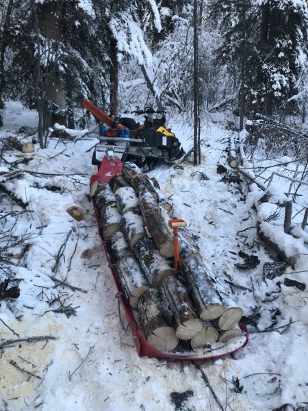

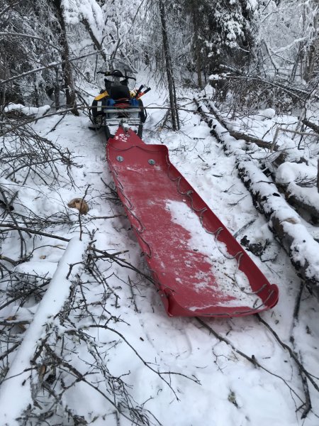

  20. Rope
    Rope
    Oct 16, 2017
    5,356
    30,824
    Alaska

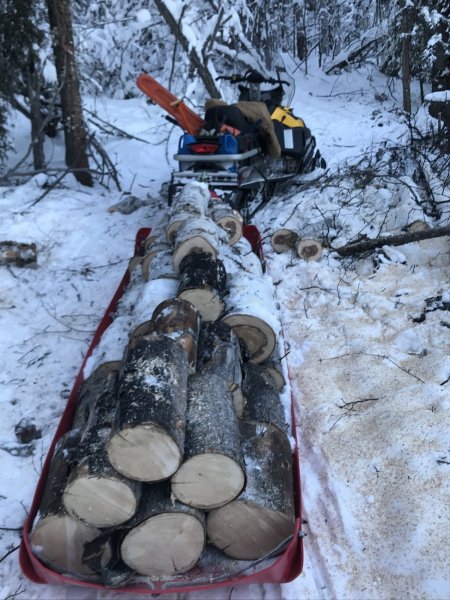

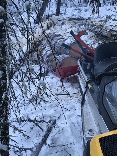

    Once the primary trail is in and froze down it’s not a issue, when your empty break the new trial where you will cut the next day and you will be fine. 1F0129BB-2E85-4CDE-9922-C9CAAC71A948.jpeg E47D9083-4EB1-4B6A-B4AA-AA830BF8C5DF.jpeg A62F7EE2-2B1A-453D-88C4-13EB619CC71C.jpeg C2D9CCA1-CF0A-4F79-BF1F-584EB3E90453.jpeg B5A7B338-1EBA-4558-A506-55CB0EB47C24.jpeg A76C39D3-6420-4EB0-B1E6-0DA968BAB243.jpeg 47CFBBA6-EDA4-42FA-B28F-777CB7DC6335.jpeg
