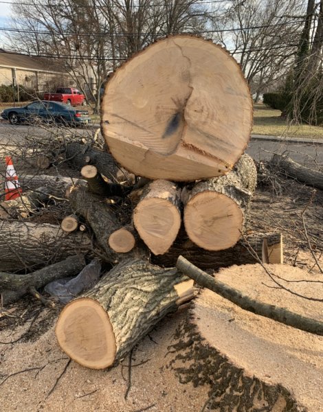

    A4D96CC8-AC6B-498A-83A0-A5726A4746F0.jpeg Thanks to many of you for warning me about metal... I think I can already see that it has some.. noticed a stain on the stump end in my pics.... what do you all think? Metal? Mark from chainsaw bar?

    What does the actual stump look like? If the stain matches, might be a little metal in it.

    Looks just like the stain that my daughters oaks had in them, METAl! What ever it was, its been there a long , long time. Know anyone with a metal detector? Might not be a bad idea to check it.

    the blue stain in the middle is metal in the tree , hope you find it splitting and not cutting
    looks like your chain has stained a bit too, happens with green red oak sometimes

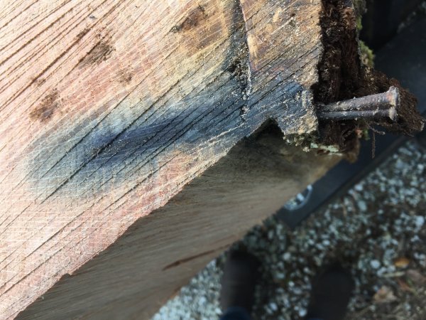

    Definitely metal in there somewhere! Be careful, take extra chains. Being it's in the center of the log, it'll be hard to tell where it actually is. Pic showing how metal leaves the exact coloration you are seeing.

    Hopefully you can cut a round above the metal then split the round.

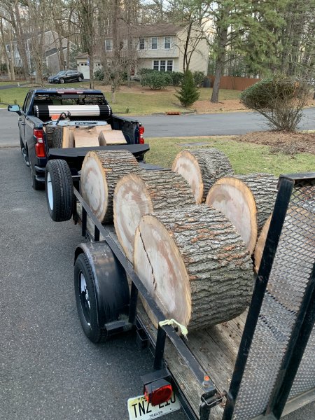

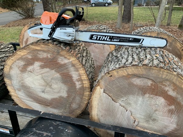

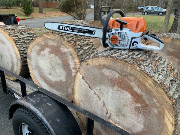

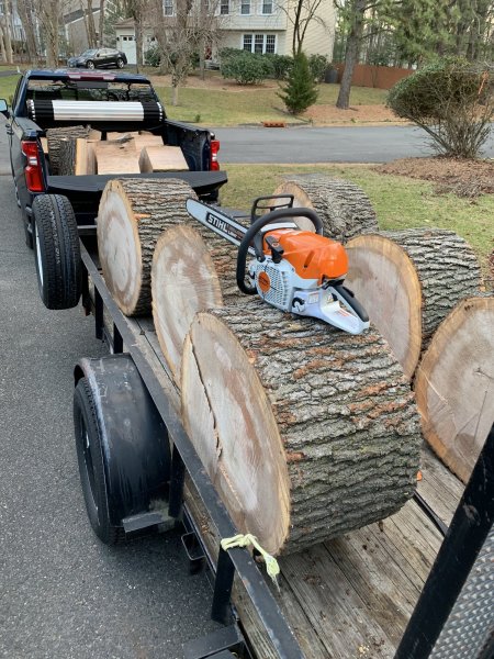

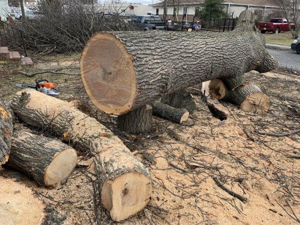

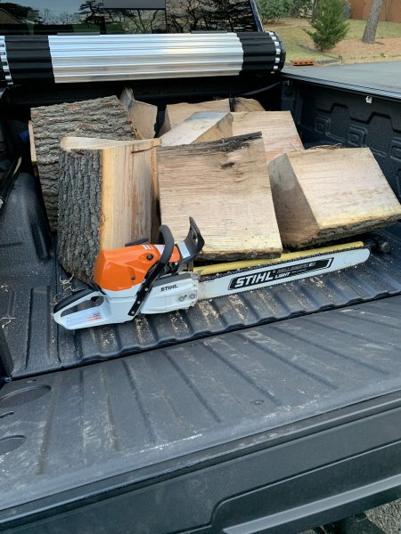

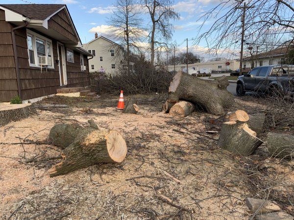

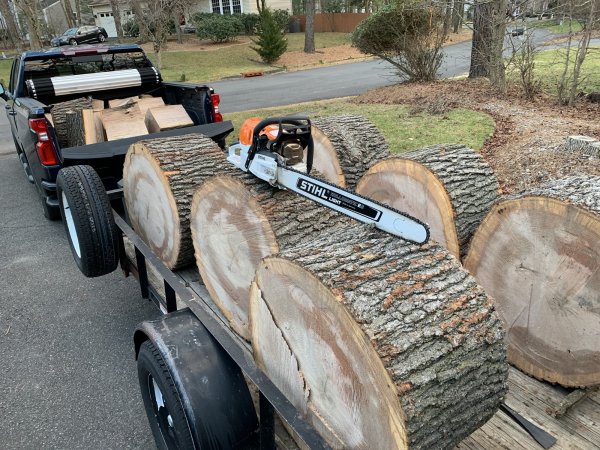

    finally had a few hours to play today and as luck would have it the big wood was still there! What a beautiful day to break in the new 462... was sunny in the mid 40’s after a week of straight rain. The saw with the 28in light bar was amazing and near perfectly balanced. After giving that big trunk another look I decided to tow strap it and pulled it down almost to the ground. From there I was able to place other rounds to support the log as I cut. I planned out each cut carefully and took my time. All went very well as it was incident free. Another fellow hoarder was there taking smaller stuff and offered to help me tackle the bigger wood. I was very glad for the help and I cut a few extra rounds for him and we helped each other load. In all I took home about 8 rounds ... 6 in the trailer and 2 noodled and put in the truck. Rounds were about 32in diameter. What a day... First wood haul in the new truck and first couple tanks through the new saw. Thanks to everyone here for all the great advice. I was sure to tell guy helping me to to look up FHC and sign up. I could tell he was as happy to talk all things firewood as I was.

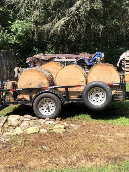

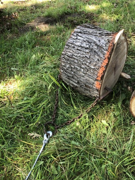

    86A9C659-0230-4C09-9EB9-2B0AD3B1A3F9.jpeg Here’s a quick vid of how I get those big rounds on the trailer with hurting my back any more than it is.
    First time so we went slow to make sure there were no hang ups. Sorry, can’t get video to load.
