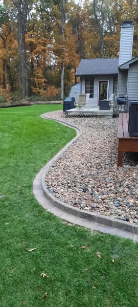

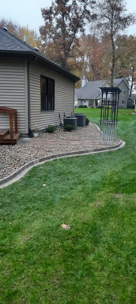

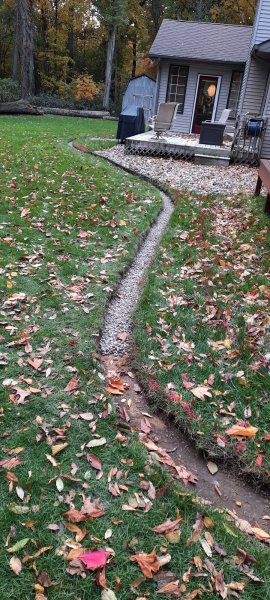

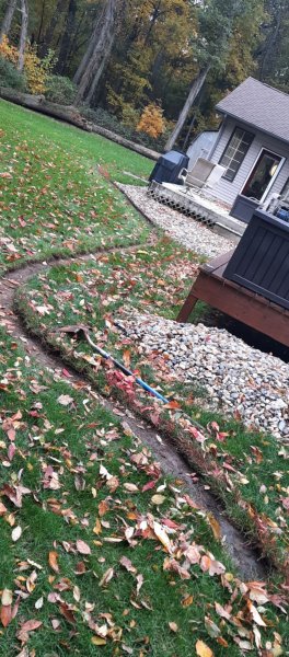

    Here we dug out the sod and filled the trench with about 2" of crushed rock. Smooth it out decent and packed it down good. Then about 1" of clean sand. No stones of any kind. Smooth/screed the sand with a 4' level. Then set the pavers and level them. Obviously your project is a little different but the basics are similar.
    20211102_145025.jpg Screenshot_20211109-184332_Gallery.jpg 20211109_162328.jpg

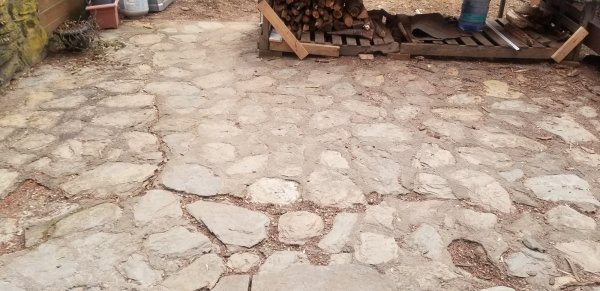

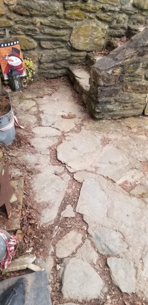

    Thanks Jeffrey Svoboda . I've read several articles and watched tons of videos but haven't seen any where they have used a previous concrete pad as a base. At least not for dry laying pavers/ flagstone.
    Here a couple pics.

    Yea I'm not sure sand would work good as a base for your new stones on top of that pad. Likely would hold water in spots. Plus it looks pretty enclosed in like water can't drain out all sides or at least 3 sides away from the house.
    I would think about laying your new stone down like tile. Mix up some concrete and glob on the back of the new stone. Lay new stone down on old stone and mush it down. This way will be time consuming to figure out how much concete needs to go between the bottom layer and new top layer. Then once the whole top layer is set, mix of a thin slurry of concrete to pour between all the new flagstone. That way your new patio is sealed up.
    The key would be to keep it sealed cause any water that makes its way between the two layers can freeze and start breaking up the new layer. This can also happen with a sand base over the existing concrete if the current pad isn't sloped good for drainage.
    Obviously this is all after you make the current slab as flat as possible.
    The best thing to do would be to break it all out. Put in a good drain system. Then build up a good base for you patio. All the water/moisture will be carried away so nothing can heave when it freezes.
    Hopefully that all kinda makes sense.
