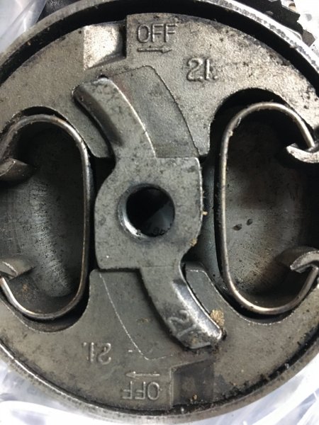

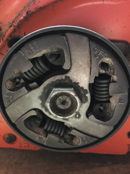

    I use an old boot lace in the plug hole being careful not to let it go into one of the ports, then typically a screwdriver and hammer to remove the clutch drum, or the scrench. The straight screwdriver goes in one of these two cut outs to the left of “off”, then rap on it a couple times.
    Here’s another style that takes a scrench.

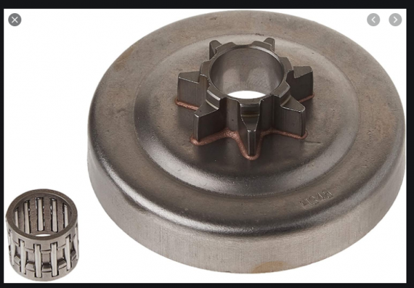

    Joe, I'm pretty sure your Rancher doesn't have an easy replaceable sprocket, it's a similar setup as my Husky 350. They have the drum and sprocket as one piece, so you'd have to replace the whole thing. Your new one will have a separate replaceable sprocket though. I have a couple tools which you place into the spark plug hole to stop the piston. I then have a clutch removing tool as well.
    As far as replacing them that often....no way! Replace when they wear out. Only time I have swapped sprockets is when I was playing with larger ones for more chain speed. I do run a larger one on my 346XP.

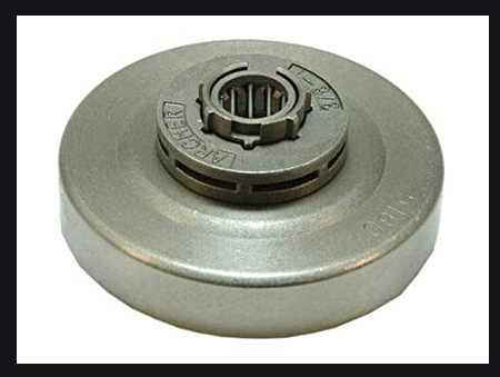

    Does no good when the OP's saw doesn't have a replaceable rim sprocket though. I'm pretty sure the Rancher's all have an all-in-one clutch drum/sprocket.
    Like this:
    Not this:

    I'm guessing you can, at least on some saws. I'm pretty sure the clutch drum on my 346XP would fit on my Husky 350. You just gave me an idea! :D I can pick up a clutch drum for a 346XP, as I have the stock sprocket from that saw I can use to convert my 350 to a replaceable sprocket setup.

    Watch crossing those 2. The worm drive (the plastic gear to drive the oil pump) has a different spline size/pattern. I've been back and forth with 3/8 and .325 on my Jonsered 2150 (essentially a Husky 350). Yes you can convert a spur clutch drum to a rim drive sprocket style. Just need the right parts.
