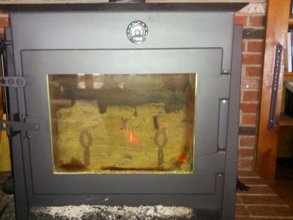

    That last pic looks like there is more in there than there really was. That is the last row of bricks and there is not much left of them. Probably a few more hours of low heat.
    So 8am Saturday to 10am Sunday - 26 hours. Plus a couple more hours, but I was gone for that.
    This is as low as I could run the stove with these bricks. The air was pretty much all the way shut during 80% of this.
    I did open up the air Sunday morning around 8, bringing the temp from around 250 up to 300 while it burned it's way out.
    -Oh yeah, and don't try this at home.....
    My IR (non cat) packed full like this with a hot bed of coals might get scary. I do 40lbs in that.
