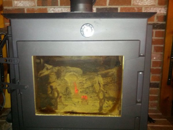

    So now that is is warmer out, just for fun, I wanted to see how long I could run the stove and keep the house warm.
    I stuffed the stove with 80lbs of the Canawick bricks (2lbs a piece). They come in 40 lbs packages, so 2 seemed like a good idea. It was mostly full. I could have fit in a few more. I did have a smaller bed of coals when I started this.
    During this entire time it was 30-40 outside (night and day)
    Start - outside temp 30, inside 72 - 8 am

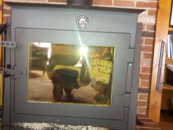

    A couple hours later - front stove temp 750-800 top 550-600 - inside temp 75
    air is already most of the way down. 10 am - gone to work (a Saturday)
    sorry for the bad pic
