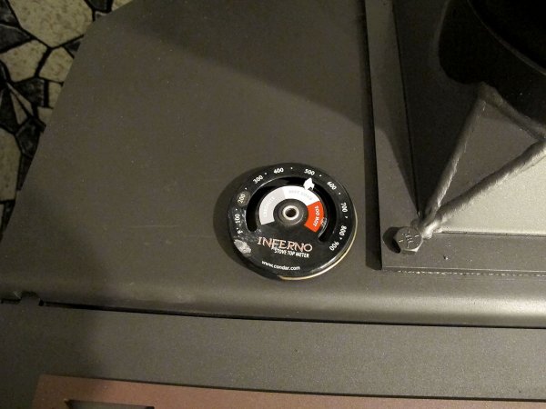

    • The cruise range for my stove/flue/climate etc seems to be STT @400+'F and single wall flue temp of 210'F give or take a 20 degrees depending on burn stage.

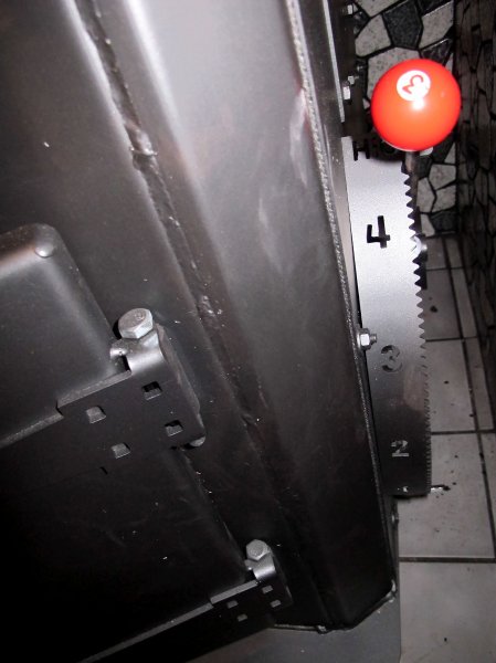

    • One nit: The draft control on the stove is this fairly long "Stick shift" labled from high and the top to low at the bottom. It runs along a serrated steel guide. The lever has plenty of granularity, almost infinite control, but it makes a lot of noise running along the steel serrated guide, which holds it stead at whatever setting you pick. The noise is annoying they are working on a better guide/lever system for this.

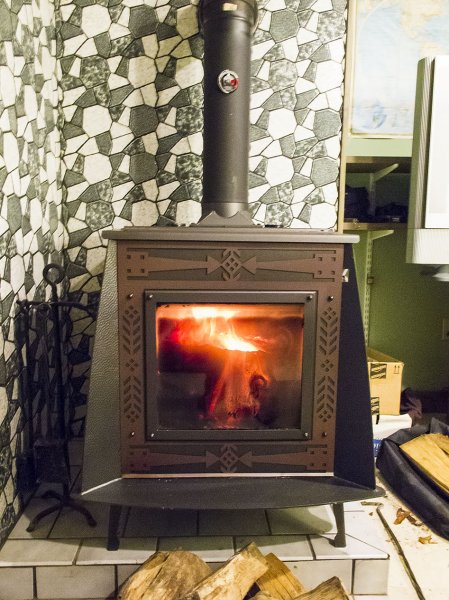

    Here are some more pics of the stove and the initial break-in fires. I'm trying to capture some of the controls and operations of the stove.

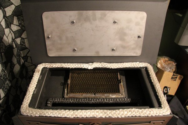

    Here is a look inside the top lid down to the cat. Also, not that directly in front of the cat is the bypass opening from the firebox and it is in the open position right now. The small handle with the circular end on the right is the lever that controls the bypass. The cat is slanted forward, directing heat toward the front. The cat can be easily lifted out for leaning of needed. In the next pic you will see the "Cat hood-scoop" which just sits atop of the cat and directs the heat forward.

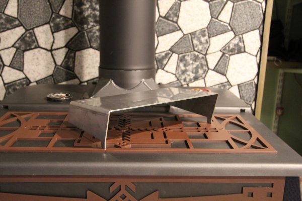

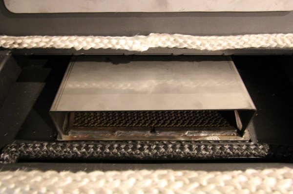

    Here's how the hood-scoop sits atop the cat. It's a cool little feature.
    Here's what the hood scoop looks like off the cat.

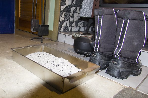

    So it's Saturday (well, actually everyday is Saturday for me) but it really is and it was like 52'F today here in north central Ma. That's crazy. So I figured I'd let both stoves go out, clean them out and clean the glass and all that kinda' stuff.
    So the Fv in the living room, I love it, but it has no ash-pan and I am really envious of these IS and Progress owners with the ash-pan. Nice thing with e Absolute Steel is it is part of the package and they have actually improved upon the system be adding 1/16th of an inch more width to the grate slots. This nicel lets the ashed fall through while the hot coals stay in the box to help with the next load.
    So today I cleaned the glass and pulled the ash-pan to see how it works and see how much ash I had. I really didn't need to do this, I actually maybe should have left the firebox alone instead of raking all the ash away, as they claim a bit of an ash bed is a good thing. But... I'm a curious guy and so I cleaned it up and pulled the ash -pan and reloaded and will wait till tonight to start a new burn. But, here's what I had in the ash-pan. I'm like thinking this is so cool because it actually is a nice size. Also, the door to get at it, and the latch are very solid and tight. So a real good feel to all the latches. The bypass lever could use a detent or something, ala the Cat engagement "click" you get when you engage the cat, but that's a nit, and would be my only feedback on the controls.
    Lorin did mention there is already some work in progress to improve upon the serrated guide/stick-shoft lever draft control. It makes annoying clicking sound when you slide it back and forth across the teeth. I could certainly live with it as is, but it may change before final first customer product ships.

    That ash pan load picture shows well what I've been seeing - there are flecks of coals in with the ash. They are quite small, and I don't feel like I'm throwing away treasures, but I'd rather burn them and empty the pan that much less often. The IS grate really did need a change because it took a lot of raking (I enjoy playing with the fire, but all that raking got tedious). The PH grate lets very little for coals through and takes less raking than the original IS. In the cold weather we rake a lot to maximize room in the firebox for the next load, but now in this warmer weather I've started raking less.

    Lorin mentioned that they are also improving on the ash-pan rails that the ash-pan rides on as it slides in and out of the carrier, as there is a slight space there now that allows the pan to tip slightly and not smoothly slide across without putting slight downward pressure on the pan as you slide it across.

    I have noticed the pan takes a little fiddling to get out, but had attributed it to me. I'll look more closely the next time I pull it out. As far as I can see, the overall stove design is rock-solid, and is down to little tweaks like this.

    Steve, nice looking boots. Not to derail this thread but perhaps you could answer this with a PM. I've thought about buying either those or one of the others that company makes. Yet, I've heard some negatives as they used to make them themselves but now they are apparently made in China.

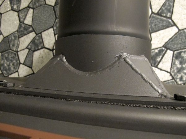

    Although I'm no welder, a good friend who is very knowledgeable tells me that the weld quality of the box is high quality. New Hampshire pride of craftsmanship is what I believe. :) /some people don't care for the wings, but I like them. I think of them as heat sinks, and they do provide a nice visual frame into the fire. I also like the ash tray around the perimeter of the stove very much. It makes the stove easy to clean up after loading and just adds to the finish of the stove. The stove's ashpan system is the same great system you get with the PH and the IS but a small improvement in the grate by adding 1/16th of an inch to the width of the grate slots which provides easier ash raking and disposal into the ashpan.
