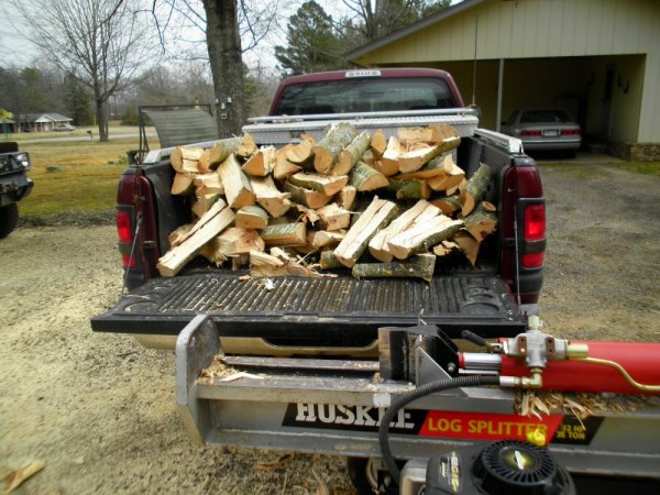

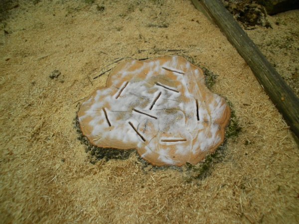

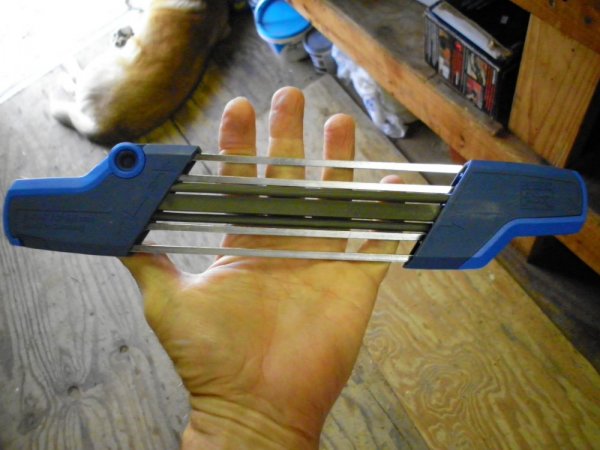

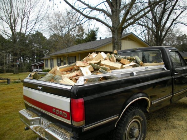

    This ones done, cleaned up wood split and stacked and bore cut the stump and put salt down it. Now to find another victim.lol Got to use my new Pherd chain and raker file too. I likes it. SANY1200.JPG SANY1201.JPG SANY1202.JPG SANY1194.JPG

    Also, putting salt on a stump is a new one to me. What is it supposed to do?

    Sweeet pics !! My dad has the very same splitter. Doesnt look as new as yours anymore :) I plan on giving it a make-over this year...hopefully !

    I was told it would kill the stump and roots, I dunno. salt was cheap enough to try it.lol

    Go to a Agricultural store (Tractor Supply Company) get a product called Tordon (red and white bottle). Its good stuff for killing stumps and brush off.

    I read that salt will kill roots somewhere

    Great looking loads of splits but I gotta know more about the chain raker file. First time I have seen that one.

    A few Arborist and loggers told me to put salt on it. I know it will kill bushes, I salted the wifes business steps this winter and it killed the bush next to them.

    Stihl has one too, same file just stihl colors and probably higher.

    Now that's cool. Never seen this before but I got to have one. Looks like a good product. I have always hand sharpened my own chains and have a lot of guides and depth gauges but never have seen this one before. looks like it works great got a have it. Where can I buy one?

    I have the Stihl version - 2n1. The Pfred is a CS-x. Odds are Pfred makes them for Stihl. They both sell for around $40. They are very simple & easy to use filing both the cutter & the raker at the same time. I really like mine.
    One down side is you have to have a different one for each size of chain. (3/8", .325, .404)
    The Stihl 2n1 uses a 13/64" file for the 3/8" chain. I don't know if the Pfred version does the same or if they use a 7/32" file. Can anyone enlighten me?

    The one I have is 7/32, They have one for each size you can order. I use mostly 7/32 on newer chain and move to 13/64 as the chain gets wore a bit. I thought I could just replace the files in it but you can't. the holes are made for that size file.
