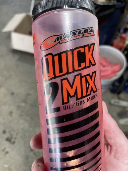

    I used to use a ratio rite until I found the maxima like Steve posted earlier. I’ve been using it a couple years. I like it a little gooder IMG_4132.jpeg

    And it comes wiff a cap as standard equipment n stuffs.

    Yeah and it doesn’t leak when you accidentally knock it over :emb:

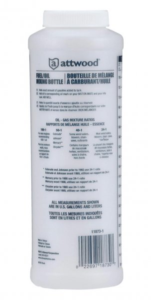

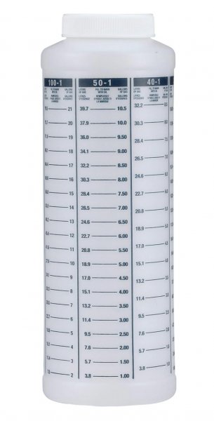

    Never seen that one before. It should do the job perfectly. I had a ratio rite for years but once I started the oil testing I wanted to make sure I was being as accurate as I could be. The graduated cylinders are definitely more accurate. The ratio rite was off a fair amount. I just can't remember which way, richer or leaner.
    Some of those little single use bottles of oil from some companies are not accurate in the amount in the bottle. Almost always less in my experience if they are off. Thats a recipe for disaster with some oils in a 50:1 mix thats actually 60:1 or something because they shorted you some lube.
