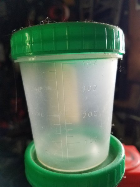

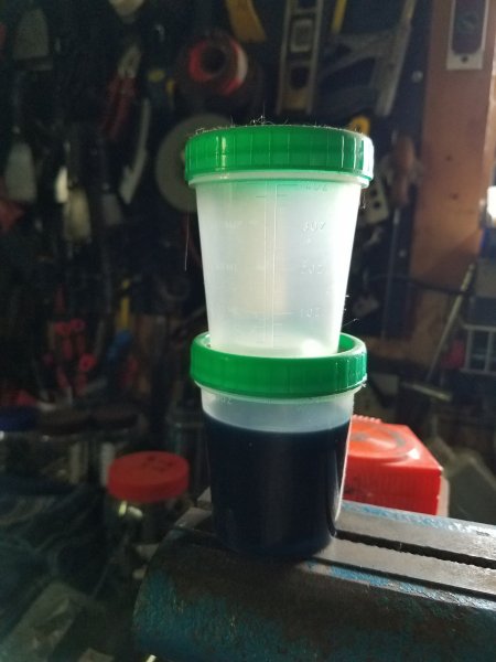

    I have a cousin that works in a hospital and she brought me some marked specimen cups. I can fill these up ahead of time and take some along if I'm cutting off site. I fill up to 3.0 ounces and add to a gallon of gas, swish out with a gurgle of gas and I should be at a 42.1 ratio or thereabouts. Isn't any different than a ratio rite or any other container to measure, I suppose, but they are really handy. 20200729_115715.jpg 20200729_115730.jpg

    This is exactly what I do. I run Husky XP or Red Armor.

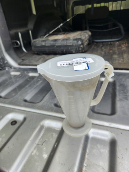

    Look what just came in the mail !

  13. RCBS
    RCBS
    Jan 22, 2016
    6,584
    33,070
    Over here
    Was hoping he was gonna pull the jug. I like to see the bottom end when speaking of mix oil and ratios. Want it looking a little slimy. Is this the oil that some run at 100:1?
    metalcuttr and Eggshooterist like this.
