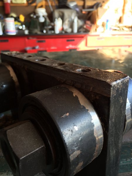

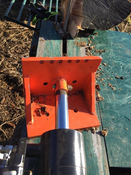

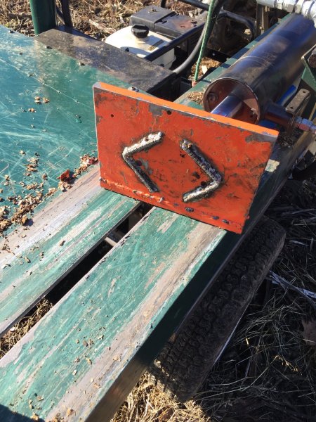

    OK, the reinforced cylinder mount and backing plate are installed:
    I replaced the hoist valve with the one from my nephew. We set the pressure relief valves on the control valves to 2080; this was the most I could get before stalling the engine. I need to tach the engine because we both feel that it doesn't "sound" like it's running as fast as it should. Even at 2080, I am getting a true 20+ tons out of it.

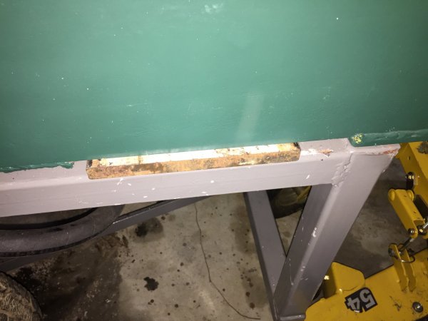

    What I found when working on the valve however was that one of my tie plates broke:
    It's kind of hard to see but the weld did not fail, the plate broke. I used an old plow blade cutting edge and it must have been hardened to some degree? In retrospect, I think the "bang" I heard was that plate breaking. I bought some mild steel plate today that I hope to replace it with.

  5. Kevin in Ohio
    Kevin in Ohio
    Oct 15, 2014
    1,067
    6,287
    Yes, Plow shares are hardened and snap easy. I made the mistake of using one for a wedge cutting r=edge when I was still in high school. Snapped the first time a twisty know piece put an extreme force on it. May hold an edge better, but not stress. They aren't hardened like a good tool steel because if you try to weld that stuff, the porosity and cracking is obvious.

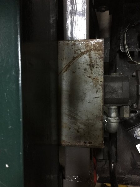

  12. Deer Meadow Farm
    Deer Meadow Farm
    Nov 3, 2015
    681
    3,433
    Warren, MA

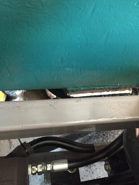

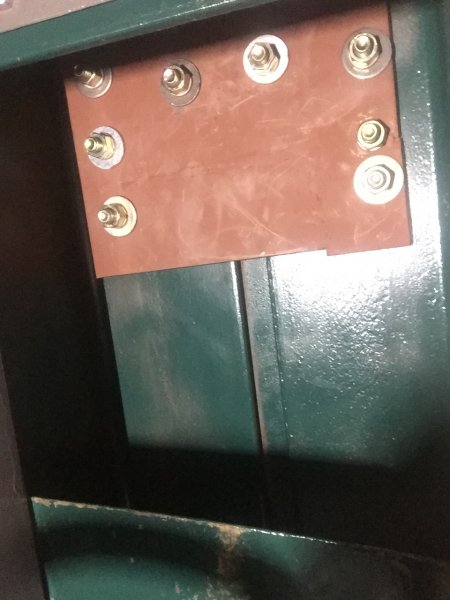

    I bought some plate at the metal yard yesterday. I found an 8" wide plate that I will weld to the vertical legs of the angle that make up the beam. It will be placed around 2" forward from the leg of the angle that boxes in the back and coincides with the rear edge of the tie strap that broke.
    It is long enough that it'll reach the chassis on the other side so I'll cut it flush and probably bolt it to the chassis as well.
    I also have a 4" wide strap that I plan to weld to the vertical legs of the angle that make up the beam just forward of where the strap broke. Boxing the beam in this way along with the previous upgrades to the rear cylinder mount should eliminate my issue. Question now is, where will it break next? :emb:

  15. Deer Meadow Farm
    Deer Meadow Farm
    Nov 3, 2015
    681
    3,433
    Warren, MA

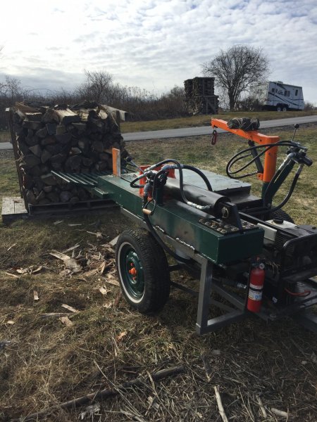

    So, I welded those plates to the beam (forgot to take pictures) and split wood on Saturday. So far, so good! 007.JPG
    Edit: Guess you can kinda see the welds in this pic.

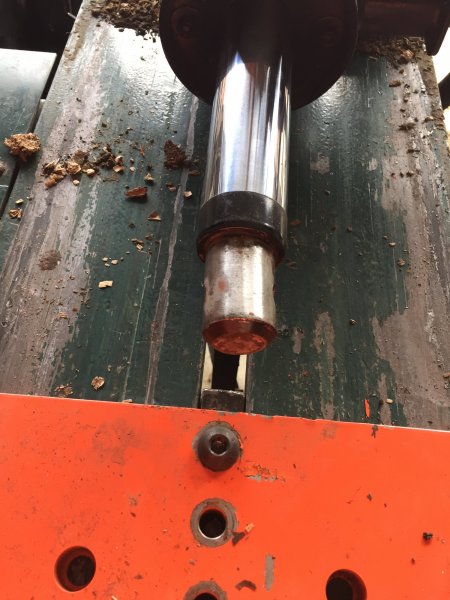

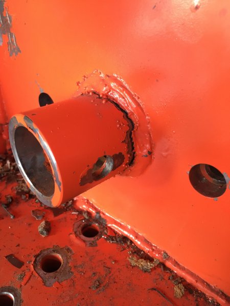

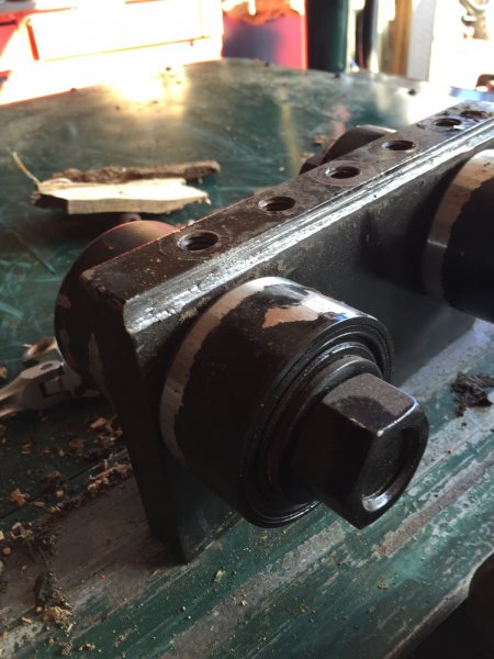

    Found the next weak spot.... :(
    Broken push plate 1.JPG Broken push plate 2.JPG Broken push plate 5.JPG Broken push plate 4.JPG broken push plate 7.JPG

  20. Deer Meadow Farm
    Deer Meadow Farm
    Nov 3, 2015
    681
    3,433
    Warren, MA
    No it isn't...
    Thanks Lyle! I'll figure it out...
    I'm going to try to straighten/reuse this one first. Another cylinder of this size is around $400 +/- and has the same style of attachment.
