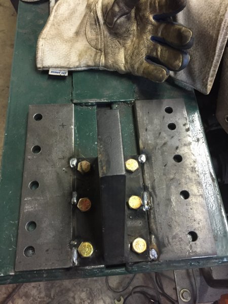

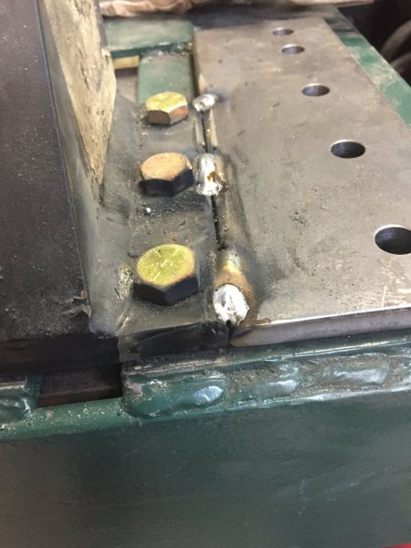

    Please ensure your welds are getting full penetration, I see a few areas that have spaces between start/stop. :)
    Horkn and Canadian border VT like this.

    Nowhere in the above did I claim to be a welder! :whistle:
    The picture above I did with my old stick welder... My welding skills have improved since getting my MIG, but yes, point is taken!

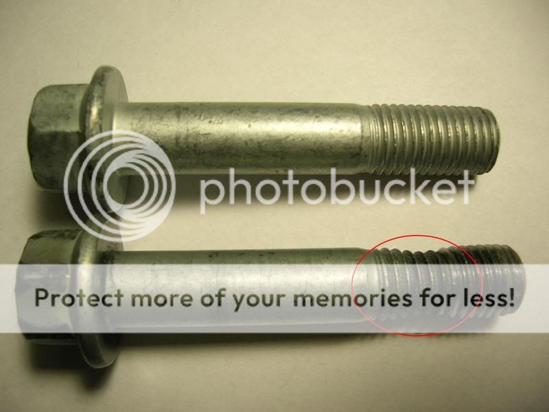

    Sounds right .. If you overtighten or reuse the bolt becomes plastic and will fail.. In mission critical applications such as yours one time use and installing with a torque wrench is your safest bet.. P&G had a fastener course that illustrated what happens when bolts are over tightened.. There are other factors which affect fasteners such as lubricating them can cause over tightening as well..
    The picture above illustrates when a bolt becomes plastic and severely weakens the bolt..

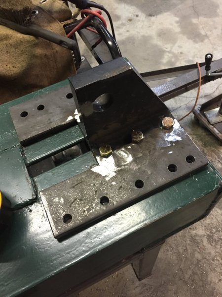

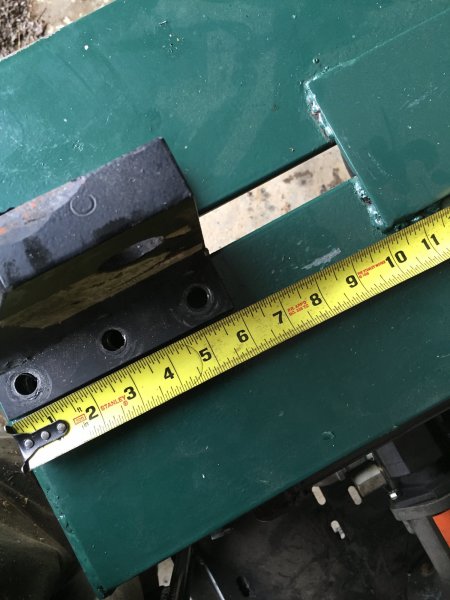

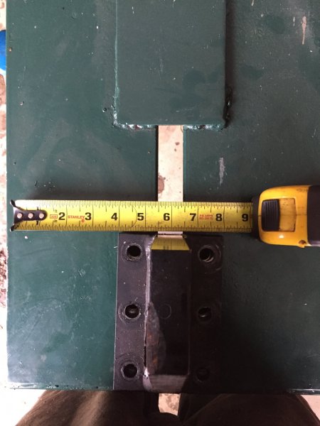

    I made the additions to the cylinder mount. I ground 45° chamfers 1/8" deep on both sides where the welds would be. I think I got some real good penetration that way:
    I welded both sides of the joint carefully to minimize warpage. I stitched the top, then flipped it over, stitched the bottom, flipped again, etc. until it was fully welded:
    Then I ground everything smooth. This is the finished mount (minus paint):
    I took the 8" square drops and cut sections, beveled and welded like above to end up with a plate that is 10½" wide x 11¾" long (front to back) to use as my plate under the beam. I didn't take any pictures of it yet. I still need to drill the last holes in it. I may run a "keel" as ljohnsaw mentioned but only for the length of the backer plate. I haven't done the calculations, but spreading the load like this I think is sufficient with or without the keel.
