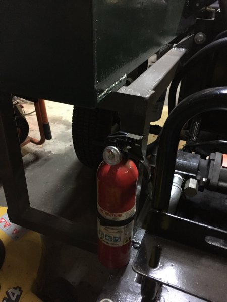

    First, the update: Added a fire extinguisher I had from a vehicle I sold:

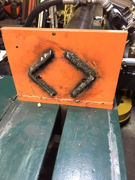

    Also added "teeth" to the push plate:

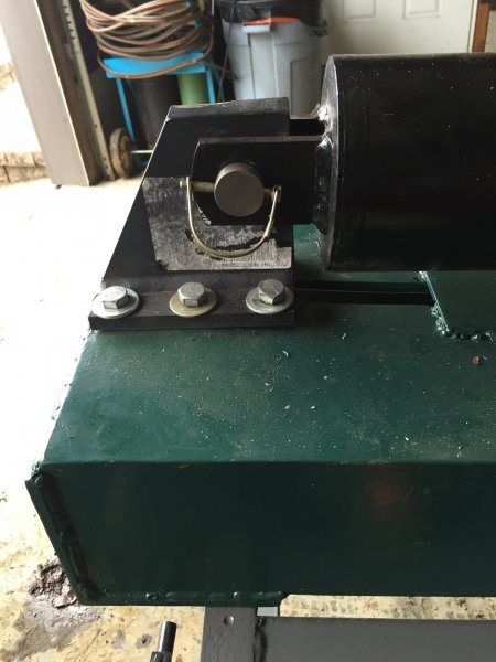

    Now for the failure. I was splitting wood yesterday and I had completed over 1/2 cord. I picked up a large knotty chunk, but nothing worse than I had split previously (?) and I heard a loud "bang". I stopped everything, looked everything over as best as I could and finding nothing amiss proceeded to finish splitting the chunk and the remainder of the pile with no real issue. When I got back to the barn, I noticed a missing bolt on the rear cylinder mount. Upon closer inspection, I found the beam had also bent! I went to remove the remaining bolts and found that 5 of the six had sheared off; all of them were 1/2" grade 8. I took the mount of and used a sledge hammer to beat the beam back in shape. I am going to get some plate to widen the foot print of the base and another plate to mount underneath to sandwich the top of the beam. I think spreading the load out will be the fix (hopefully!) Damage below:

  16. Unicorn1
    Unicorn1
    Oct 31, 2013
    2,282
    8,917
    Amarillo, TX
    Yikes, what do you think was the cause of the bolt failure?

    I would think you would want some weld on that in addition to the bolts.

    Single Shear strength on a 1/2" grade 8 should be a little over 17,000 lbs each. That is if they were tightenened to spec. My guess is it was flexing/twisting/lifting as the front bolts went first and worked their way back. You could guess mislabeled offshore bolts but they still "should" have about half the strength of grade 8. Grade 2 is supposed to be over 8000 lbs.
    How thick or what size is the beam? Check the slop on your slide now too that it gave way. Force compounds as is evident here when you have narrow contact areas.
