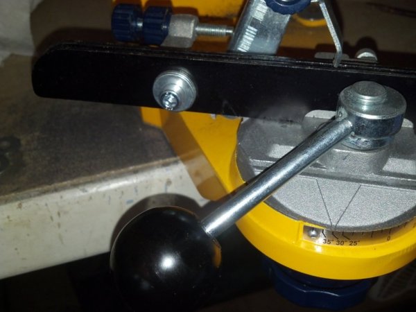

    I set the head angle to 60* and the plate angle to 30* and made VERY light pass on one cutter...just enough to throw a few sparks. Then I reversed the angle to the other 30* position and it made a pretty heavy pass. Visually they look different. When I put the calipers on it the second cutter was 0.035" shorter. Am I doing something wrong? Should I expect to have to readjust the stopper for left and right cutters?

    Maybe I wasn't clear. I made a super light pass on a left hand cutter. Then I changed to the other 30* position and move to chain so a right hand cutter was on the stop. Rather than making another light pass it made a heavy pass taking off more metal and making the cutter shorter than the opposite side.

    I adjust the stop so the left cutter doesn't even touch the wheel. Then I switch to the right position...and the wheel now touches the cutter. Does that sound right? Should I expect to have to adjust the stop for the left and right?

    Yes it will normally be off because now your trying to slip over the top of the cutter. The other side you don't have to. Now once you slip over the top you can adjust the stop into the cutter. I leave the stop where its at and slip over the cutter and then at that point use the stop. You can mark your knob and spin back slip it in and turn back to pre set. Until you get the hang of it.

    Alright I just tried it again. I have to adjust the stop about 1/8 turn back when switching sides to keep them even lengths.

    Think I got it figured out now. Made a test cut on a freshly ground chain and it rips. 362 is running awesome too.
    Had to add a couple washers to the clamp rails get it really dialed in. Without them it was too wide and the chain fell down into the clamp.
