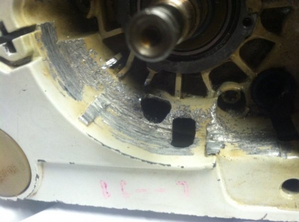

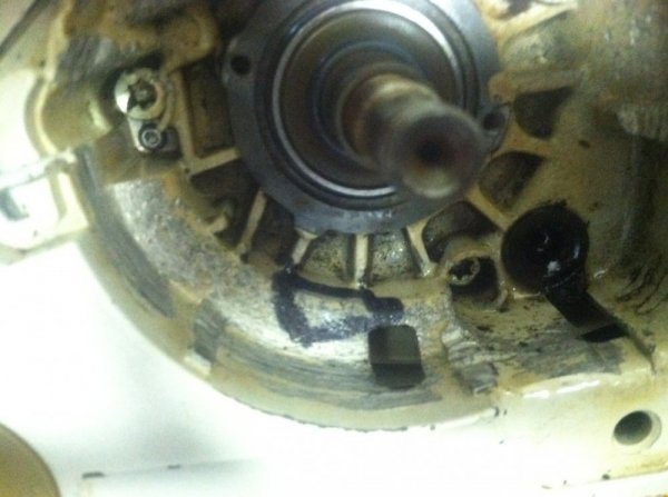

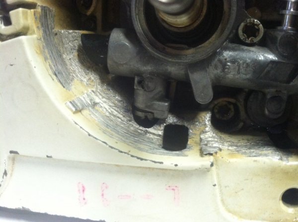

    I put the adjustable pump in as close as I could get it and traced around the projection that gets in the way with a magic marker. The hole wouldn't have to be quite so large, but you get the idea:
    The hole for the oiler might end up merging with that rectangular cored-through hole in the original casting, and the combined void might look big even if it doesn't compromise anything meaningful.

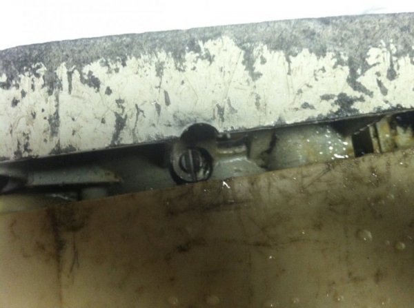

    Ya convinced me. Easy access from below, full range of adjustment:

    Thank you very much. It's neat what you can do with a drill, a Dremel, a sharp burr and a couple of chainsaw files. The necessary opening is right up against a rib that you can sorta see in the pic taken from the bottom, but doesn't cut into it. I don't think it's a structural problem at all.
    I just got the saw all back together, so I should be able to try it out later today.

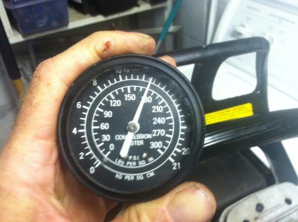

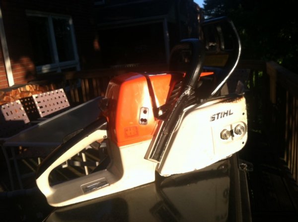

    My current understanding is that most 034's did have adjustable oilers, and it's only the earlier ones that don't. This one also has the rarer 2-part brake mechanism dust covers, and a side-access chain adjuster. And it stands out in one other respect...

    Whoa!! 180! Can you see a gasket on there? That should be a good runner.
    Is it open port or closed port cylinder? I just learned from MM that they made a CP cylinder for the 034. The 2 I did were both open port. The last one turned into an 036 before it left here. It's now a part of Swags line up. That was a good running saw as well.
    Chvymn99 likes this.
  20. Jon1270
    Jon1270
    1,886
    4,543
    Pittsburgh, PA
    Base gasket is present. I'm having a tough time seeing whether it's open or closed-port. Any tips on that? Can you tell by looking at the outside of the cylinder?
