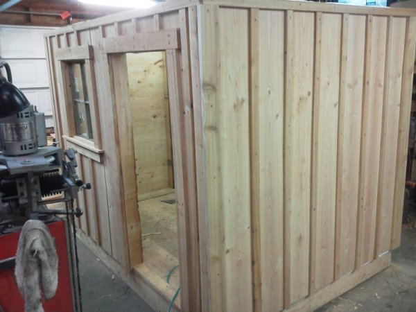

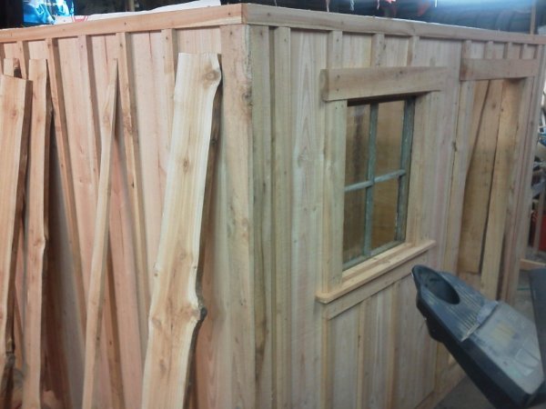

    if they are still wet ,butt together they will shrink some still ,i put some wet cedar on my shed ,it cracked when it dried on a couple boards ,a guy told me one nail in the top and bottom ,then let the batts hold the edges down ,allows for the boards to move more i guess ,if you can cut a cant like i did ,the width you want the boards ,can get a lot the same size ,but you waste more material ,i had made 2 passes before the first pic ,first one was all scrap bark ,second pass was 1.5 thick ,i can cut a couple 2x4 out of that ,the one on the trailer tounge ,then i cut my cants ,if have big enough log to get a 10-12 inch cant ,that would make nice siding with batts mhere is a pump house i did ,i sheeted with 3/8 plywood ,to keep it lighter ,but was able to tyvek it and have something to nail to ,this was all milled with a chainsaw ,on the norwood jig pump house 031.jpg pump house 029.jpg chainsaw mill wood 042.jpg

    That's some very nice work trx. Maybe what I'll do is just keep stockpiling my random width boards and when I have enough that are the same width, then I'll go the board and batten route. Thanks for the inspiration!

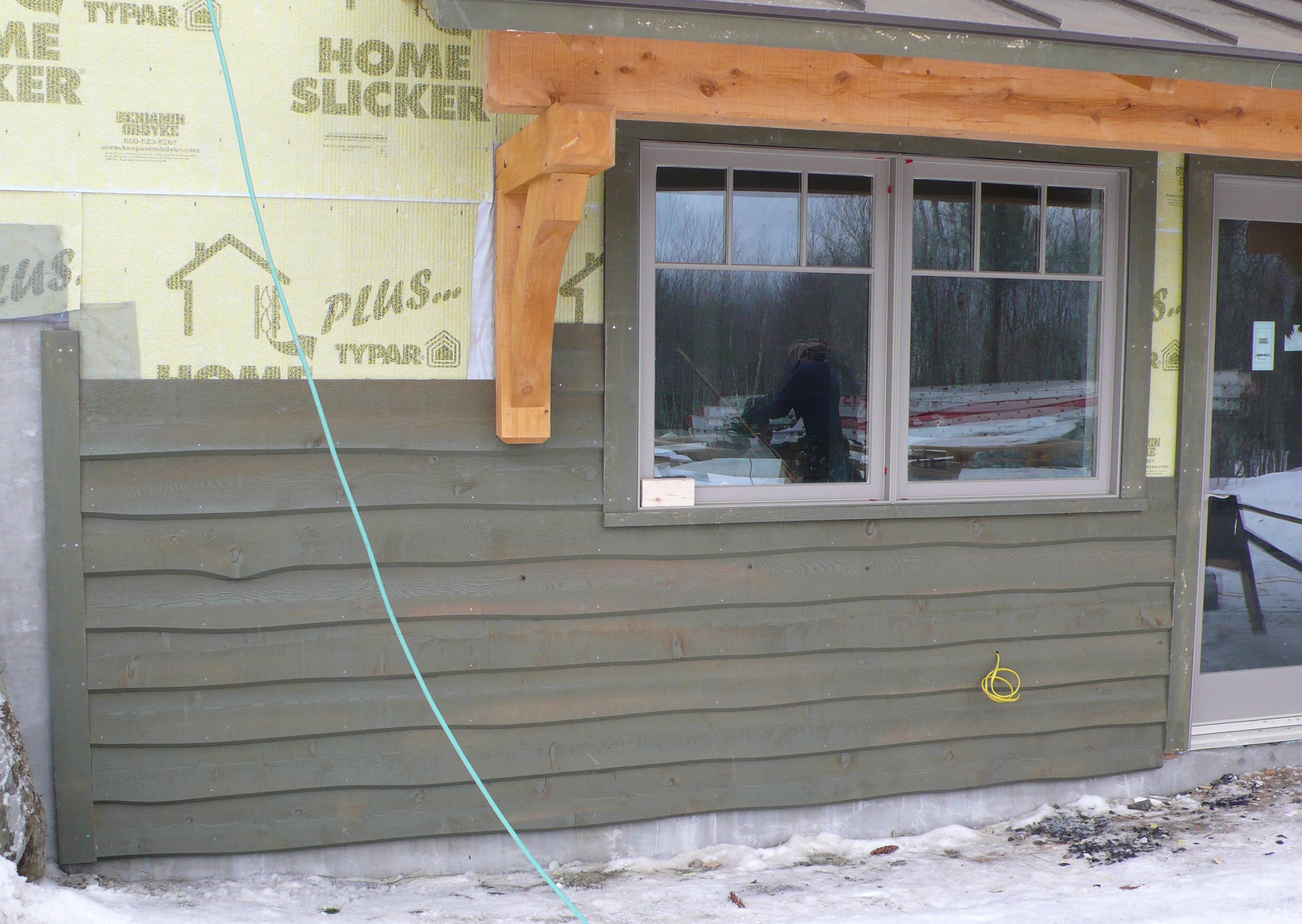

    google live edge siding ,i think a shed would look real good with it ,sort of log cabin looking [​IMG] [​IMG]

    You know what trx? Live edge just might be the way to go. Your suggestion reminded me of a youtube vid I watched awhile back. This guys got a great channel and his cabin is sweet. Check out the vid when you get the chance.

    I always wondered how they got that edge look on the siding. Makes sense now when you see how it is done. I prefer that over board and batten siding as the water is always shed downward and not able to be blown under the batten. Our rain here is quite often horizontal.
