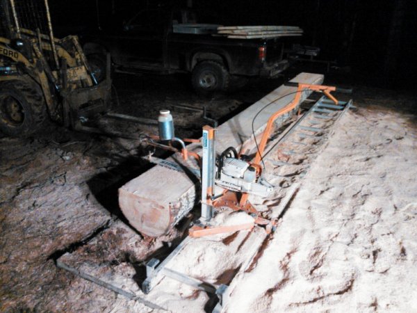

    That's friggin beatiful trx!

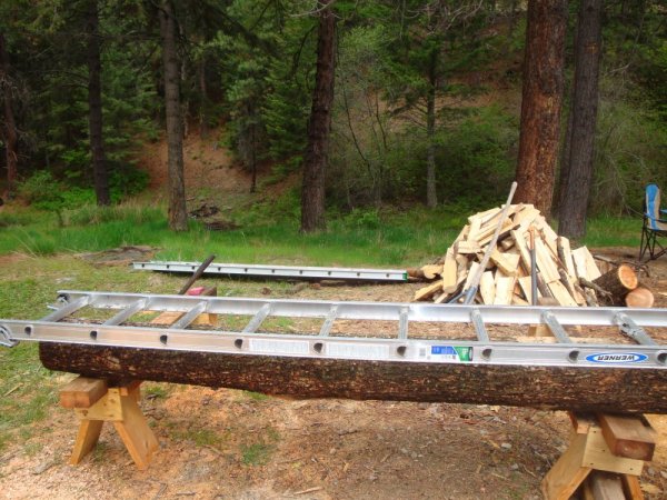

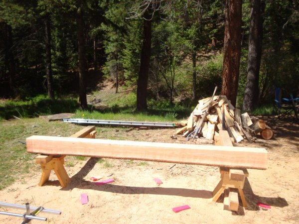

    Well dammed if your 'ol buddy Trundle didn't manage to make a friggin 6x6 beam today.
    Logs on the ponys and ready to go.
    Got er' sawed to two sides. Too late to quit now.
    3 sided now. This is where I screwed up before.
    Nailed it! It's only a 9 footer, but she measures out at 6x6 all the way down so I'm declaring victory!

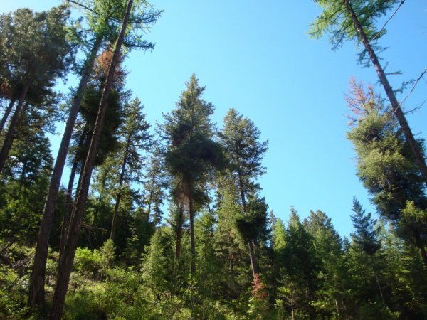

    Ok, here's what I'm dealing with.
    This pic is sort of deceiving as it makes the trees look smaller and the slope look steeper. It shouldn't be too tough to get 'em where I need them. I'll probably be eating those words, but we'll see.

    fir seems pretty easy to go where you want it with a couple wedges in the back cut

    I agree. Green doug fir is about as good as it gets (in my experience) as far as steering it with hinge wood. These ones are inclined to go either straight down-slope or quartered down the slope. The ones on the right side of the pic I'll put quartered down and the ones on the left I'll put straight down just cause that'll give me the easiest pull angles from the road.

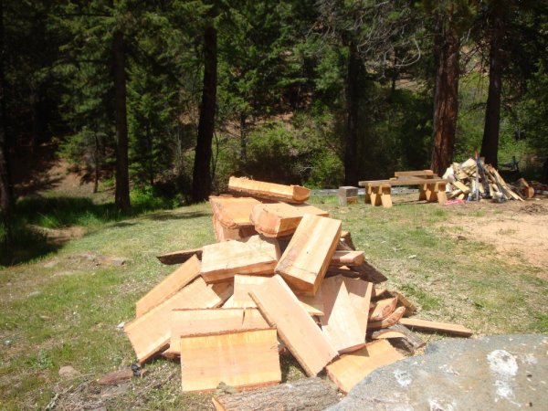

    Got my milling area cleaned up and the cut offs from the last few days sawed into stove lengths. Nice by-product of milling your own lumber for sure.
    edit - yes, that is bird crap on the rock at the bottom of the pic. The robins have been going crazy around here lately.

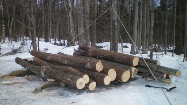

    Hey Trundle. Just found your thread and the parbuckle idea. Here's what I did this winter with not a lot of hassle or pull needed...
    Pulled with the ATV. Because you'll be only using nice straight logs for milling... parbuckling should work perfectly for you.

    i have been getting so much of that from the first cuts ,i ended up putting most of it in a bon fire ,hated to do it ,but they were thinner scraps and hard to stack ,i make 1x4 ,2x4 ,2x6 out of the first passes ,so my scraps do not end up making too good of firewood ,with an alaska mill it ,may be a lot of work to get the smaller boards ,i have never actually run one yet
