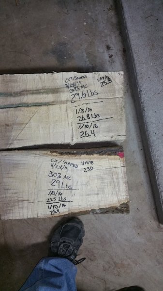

    Jan. 17, 2016
    Weight 25.0 LB
    5 lbs water lost / .2230Pts % = 22.42 %pts lost
    30% MC original - 22.42% lost = 7.58 % current MC
  8. bobdog2o02
    bobdog2o02
    Nov 19, 2015
    3,005
    10,406
    Drury Lane, PA
    Piece #2
    Weight when cut = 29.6
    %MC - 30% per MM
    29.6 / 130 = .228 parts of wood and water
    100 * .228 = 22.8 lbs of wood
    29.6-25.8 = 3.8Lb water lost
    3.8/ .228 = 16.6 %pts lost
    30-16.6 = 13.4% current MC

    Starting weight was 29 lb, loss of 4 pounds. So it's moisture content is going to be about what the other piece is.

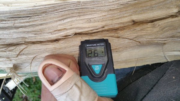

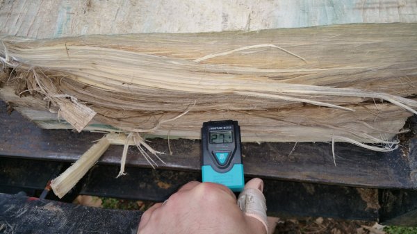

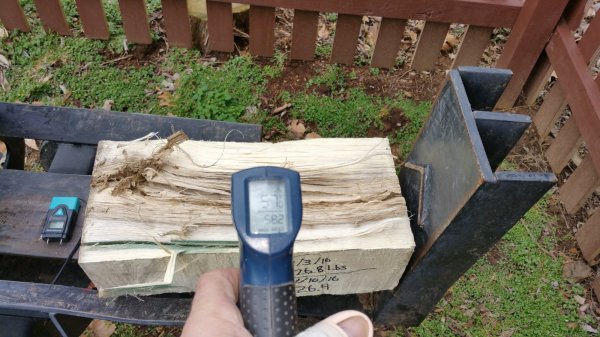

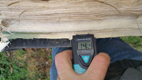

    So this ended a bit different than i thought it would, I split the heavier one. It was dry enough to be miserable, stringy dammed Hackberry. My 5ton Homelite electric in the stove room wouldnt do it so i had to go out and use the gas machine. The pics tell the tale, as Paul bunion thought the inside was still significantly more wet than the outside. 14% in the sapwood and 26-27% in the heartwood... This is my first try at this and next time might try another species and pay closer attention to temperature of the wood, i honestly cant recall the temp the day i cut them. Its sad because i knew it was a factor but was so excited to start the fun that i forgot to take it into account. Well hers the:ithappened:or it didnt happen right. 20160117_120232.jpg 20160117_120259.jpg 20160117_120335.jpg 20160117_120347.jpg
