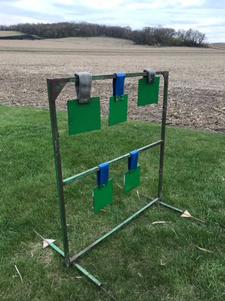

    Going to burn some ammo Sunday if my son comes out. Got my swinging steel done and all I had for paint was John Deere green. I’m thinking white would be better. I used some old fire hose to hang them.

    I like that!

    The frame is a hay wagon door I found laying in the middle of the road a month go.
    Repurposed it.

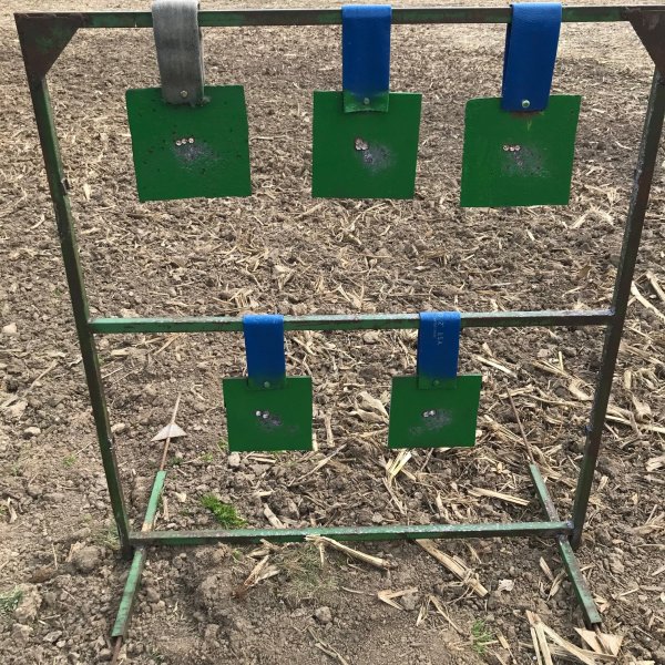

    You nailed it buddy. I need to source some hardened steel for centerfire. We had a ton of fun getting the steel plates swinging with 22’s then I brought out some hot reloaded 223 FMJ and the swinging stopped. All I did was punch holes with the 223.

    Velocity doing it's thing!
    Nice.

    Well on the bright side your groups are good.:rofl: :lol: Made the same error myself.

    I am just gonna weld the holes shut and get the grinder out. Will keep these 5 for rimfire only.
    I found a shop in Brodhead (just down the road from me) that will cut AR500 to any dimensions you want.
    At a reasonable price I have been told. :cheers:

    Try and get 1/2" plate. Don't shoot M855 or SS109 (steel core) at them and even M193 55gr ball will pock AR500 inside 50yrds.

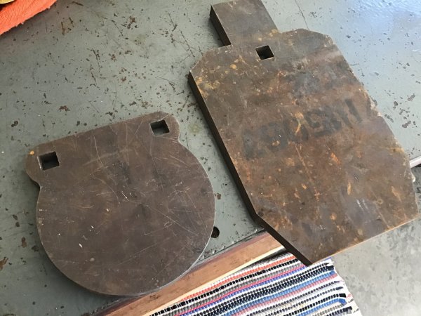

    My Brodhead metal guy fixed me up today. He had these two pieces of AR500 1/2 inch already cut. He wanted $50 but took $40. Sunday is going to be fun!
