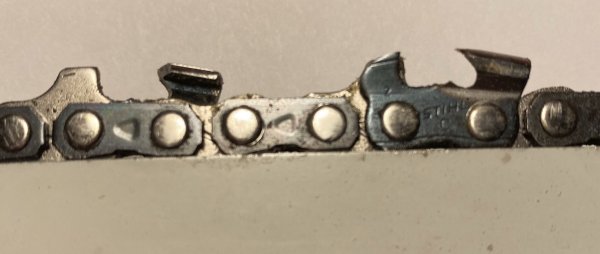

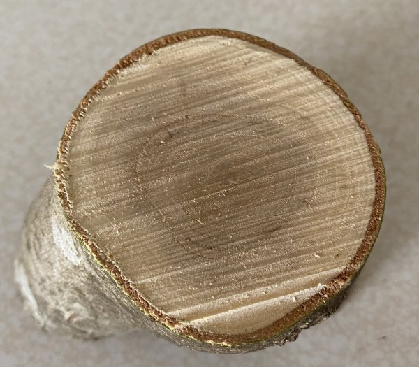

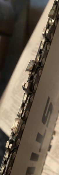

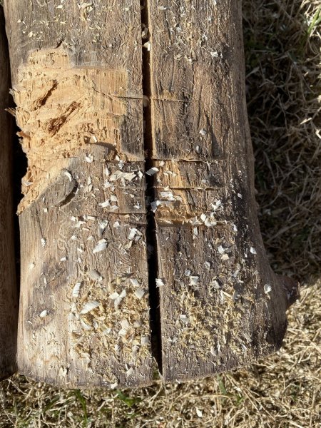

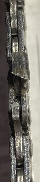

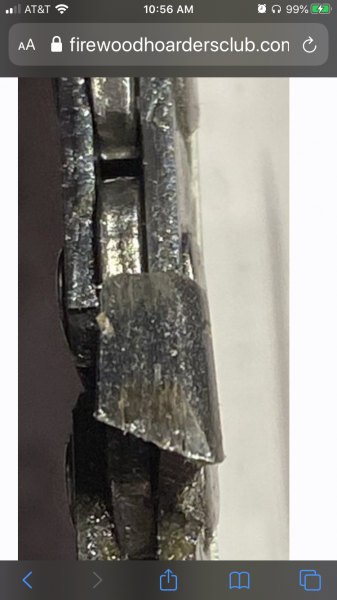

    Stihl 26RM374 Chain better pictures 03242021 (2).jpeg Stihl 26RM374 Chain better pictures 03242021 (1).jpeg Here is a few new pictures maybe it will give you view of my chain and what i am doing. Sthil Chain tooth side view.jpg.jpeg Small log used in test of cutting.jpg.jpeg Cutting Chips Stihl 26RM374 Chain 03242021.jpg.jpeg Stihl 26RM374 Chain 2nd Picture.jpg.jpeg

    Looks like your file is too small and the rakers are too low for the amount of tooth you have left.

    The file size is 3/16 it's what Stihl call for with a .325 Picco chain, what makes you say you think my file is to small and rakers are right at the Stihl gage filing height.

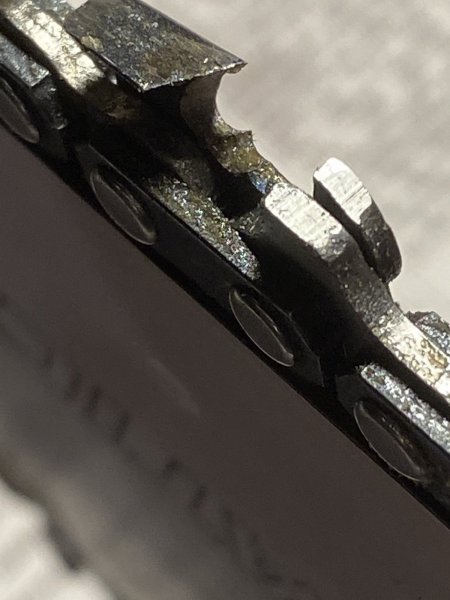

    Here's a pic of 3/8 picco chain tooth sharpened with filing guide. Im using 5/32" file in the guide as shown. Most of the time i sharpen with chain on the bar for "touch up", but in this case i knicked a rock with this chain so off the bar and in the vise for more control. The little "crest" on the bottom of the gullet should be filed flat from what ive been told but im not religious about doing that. My 3/16 & 7/32 file size chains i freehand with no guide.
    In your case the tooth has too deep of a gullet is too deep. Does the saw bite hard rather "grabby" into the cut and stop forcing you to pull the saw back and start again? In your case i would freehand (no guide) going one file size larger based on your pics. Just my 2c worth. IMG_4551.JPG IMG_4550.JPG

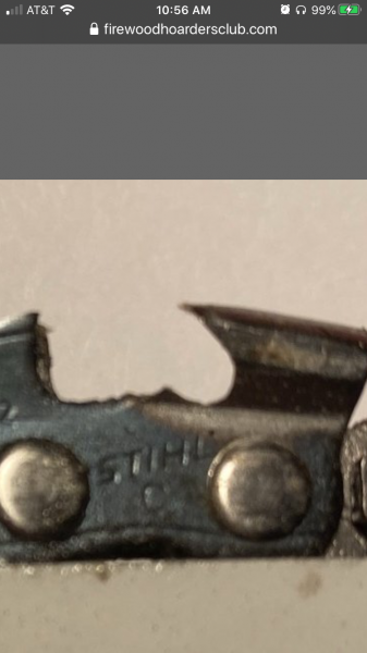

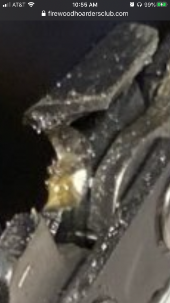

    If this is from you and not a grinder, wayyy too much hook! I’ve seen people grind that way, so hope it wasn’t from a file.
    A lot of damage on this cutter. It all needs filed off to get really good cutting performance.
    Not enough hook on this one. The file needs to sit lower in the tooth.
    Just trying to help here, so please don’t take it wrong. If you do some tweaking, you’ll notice a huge improvement in how your saw cuts. Those links to chain sharpening are very good to learn from. Lots of useful info.

    No there is no grabbing i can cut through without having to backup and restart.
