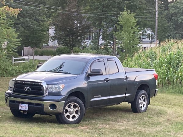

    Gratuitous pic of the new baby.
    I just cleaned some of the rust off the front bumper by the cracked chrome and the sunlight was flattering

    Looks good from here...what'd ya do then, a lil sand and polish?

    Much better. :thumbs:

    I had just taken some fine steel wool and windex to clean the rust off the bumper where there are a couple beauty marks in the chrome.
    wheels, staying with the wet sand method.

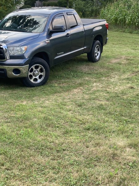

    773419F8-F190-4FD9-8C50-3D233CCEEE87.jpeg 885C9D67-678F-49F4-B126-A128DAE7830A.jpeg
    Spent some effort on drivers side rear. 400 then 600. About 4 times longer on the 400. Then a quick rinse.
    It takes a while, but I think once past the 400 phase, the finer isn’t as much effort. I guess it depends on where I want to eventually land.
