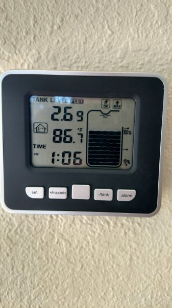

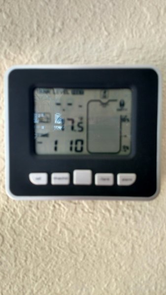

    Hi Greg, thanks for asking, there are too many projects here, they all get picked as we can. So far on this one the barter has yet to be set up, likely when we are all inside (Dec-March), but we did get the ultrasonic alarm done!! (no, its not 86* in the cistern, somehow missed that setting before mounting on the wall. And yes, it really is 77* in here ..... I've been able to save several hundred dollars so far for the new equip needed for the barter, just still irked that I FINALLY paid my truck off and 1/2 that is now going to ANOTHER increase in health insurance this Jan :confused:
    Impressive gadget for the low $$
