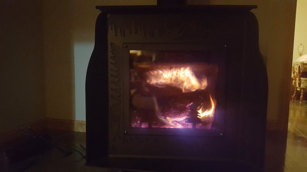

    Thanks again for all the insight into how to get the most enjoyment out of this new to me burning apparatus. My dearly beloved thinks I am some kind of genius now. Just in time for Valantines Day ;) here's a pic of my Absolute Steel making heat and looking good doing it 20170112_210649.jpg

    Very awesome pic! Bet that felt toasty! :)
