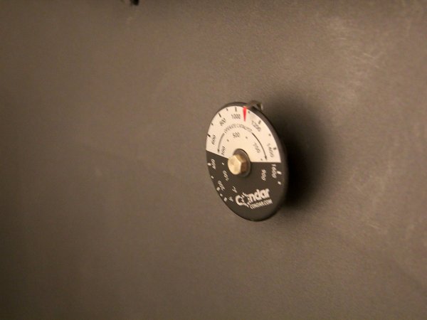

    Okay I finally got down there when the CAT was fully bright orange, but as soon as I opened the cover and the light hit the cat the orange glow disappeared. But be assured that the cat was glowing when I took these pics.
    1100'F on the Condar,
    475'F on the top plate above the cat
    330'f on the single wall pipe.

    Thanks, Oldhippie! :yes: 1100 is more what I would expect from a glowing cat. I swapped my two probes in today; With the cat glowing medium, the 9" was showing 700, the 8" was 800. :confused: Now, it does look like your probe extends a good inch over the cat, so the effective transmission distance may be reduced to about 7", and maybe that's enough to raise the temp on the dial a bit, vs. my 9" extending an inch over, from the back. I guess it is also possible that how the probes are situated could have something to do with it; Yours exits the side of the stove, mine extends straight back, in the exhaust stream for the full length of the probe....hell, I dunno.
    Still, I think on the IS, with the 4" probe, they can see temps pushing 1500. Not sure how brightly their cats may be blazing to get those readings?
    The 9" probe I have is the new style, with the face like yours. The 8" is the old style that looks like this. I think it was Todd that mentioned that they might have re-calibrated, since the numbers are in different positions on the face. I suppose that could account for a the 100-degree difference I'm seeing, but I think it's more likely to be due the length...

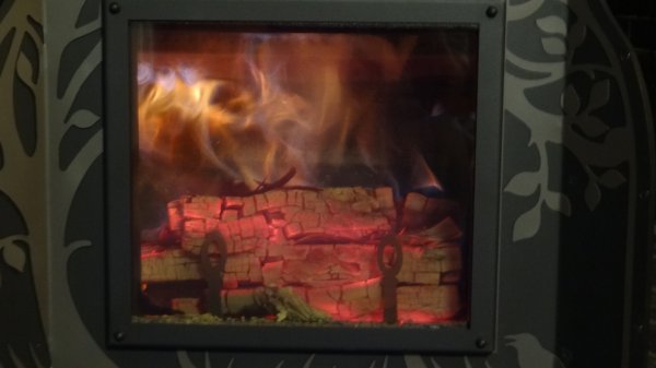

    Here's a few fire pics...

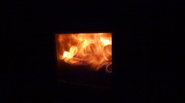

    So I woke up in the middle of the night, as us oldhippies sometimes do, so I sauntered down to check the stoves. When I went to sleep at 10PM, I had just filled the box, engaged the CAT but didn't stick around to see the CAT take off. I knew it would as I was over the 500 mark on the C0ndar probe and I've been around the stove long enough to trust it. Plus, I was tired from clearing snow the last 2 days. I set the draft at 1 and called it a night.
    So I woke up at 2AM and wandered down to the living room, and then the family room to check the stoves, since it was below 10'F when I went to bed.
    This is what I found. This happens a lot, just let the stove do it's thing. Great heat too! :)

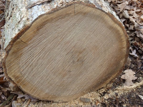

    My moisture readings seems to indicate a different reason. I can get it to engaged in flame in less than 45 minutes without gapping the Loading door or ash pan door, but usually going from cold stove to cat engagement or a secondaries burn in a reasonable time I need to get more air than the damper provides.
    Oldhippie ask about the wood supply. black and white oak CSS in summer of 2014. round here if live trees, I fell or girdle 8"-14" oak with green leaves on in june, leave alone till fall(off the ground) then CSS uncovered. then bring under roof 2-4 weeks before burning to be handy and dry (this works for such low wood usage stove it seems. and I built the house with a covered wood storage area)
    This wood has been measuring 20-15% before coming under roof at 27 months since CSS
    Interesting that the standing dead oak/hickory I cut seems to take more time to season, they tend to be 16" and up with bark still intact. not sure why. I have some I did same timing as the live trees cut with leaves on and the standing dead is still not ready to burn(25-20%). Only difference is it was stacked north and next to the other.
    Anyway I hope that answers the comments and the questioning on fuel quality.

    Could it be that partially-punked sapwood holds moisture and slows drying?

    That would be a good explanation, though not sure what punked sapwood is exactly, (spongy/soft layer of wood under the bark?) I will have to take a real close look and see.
    My criteria had been if it is losing bark ? leave it for the insects and birds, If it is on the ground ? leave it be. I have about 25 acres of Oak/hickory timber on the property where we built and process it all my self.
    I may have to consider standing dead a three year seasoning process unless I get a roof built for long term wood storage. but the trade off of stacking it tight together so it can be under roof seems to be made up by single stacks spread out and available to the sun in the summer to drive the moisture out (I know this is not the right part of forum for this much discussion on wood..please forgive)

    Right. And it doesn't take long at all for Oak sapwood to start going downhill. Hickory doesn't hold up all that well either...need to get it top-covered ASAP. You can see the sapwood layer on this White Oak. It was a live blow-down and the sapwood was still in good shape since I got to it fairly quickly.
    I pretty much grab anything dead, standing or down. That's mostly Red Oak, which seems to die more often than other species. If the sapwood is real crumbly, I might knock some of it off with a hatchet. The heartwood will stay good for a long, long time. I don't have a shed, but top-covering helps. Now that I'm ahead, I stack three rows wide on pallets. Sun may help a bit but wind is the main thing, so go two rows wide, max, when trying to get ahead. Don't split too big, either.
