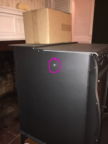

    Is there a definitive Woodstock IS Cat Probe thread, or a place in that huge IS thread where the CAT Probe mod is spelled out and preferably with pics?
    I am thinking of implementing a CAT Probe for my Woodstock Absolute Steel, but I don't know if I can find a good spot to insert a probe that will be a spot that allows accurate local reading while not interfering with the cat engagement door/vent, which is directly in front of the cat and hinged from the front of the stove.
    I'd like to see what is done on the IS and in all honesty haven't kep up with all the chatter over in the great big thread. Search found some mentions of the probe but I haven't found anything that takes me to a "how to" with pics, parts etc.
    Any ideas or help in this area?

    Is there a hex bolt anywhere near the cat area on the stove? I remember reading they were put on the IS by Woodstock per the EPA

    Yes. On the IS there is a cap head, hex screw, that can be removed and a cat probe inserted through the hole. It's right under the overhang on the top, front of the stove above the door. I'm guessing the absolute doesn't have one. Would be a nice add though.

    Yeah, no such hex screw on the AS, and when the CAT bypass door is open it opens up against that front stove wall. There are the 6 screws that hold the "radiator" onto the bottom of the top access door but none are aligned to the CAT, plus there is the hood-scoop over the cat so the probe really wants to be just in front of that. If I drilled and put CAT probe down through there, I'd have to drill through the radiator AND it would interfere with the open/close of the CAT engagement door.
    Not that I really need one, but the techy in me says it would be fun.

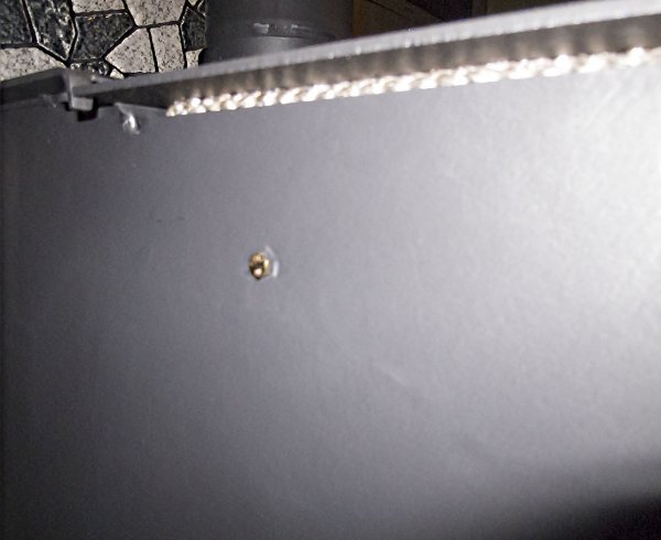

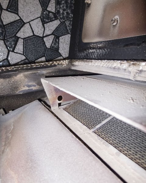

  10. Flamestead
    Flamestead
    Dec 7, 2013
    2,167
    10,974
    Windsor County, VT
    Outside...
    ...and inside...
    {edit: Note the hole they drilled into the cat shield, too}
    Backwoods Savage and blacksmith like this.
  11. Flamestead
    Flamestead
    Dec 7, 2013
    2,167
    10,974
    Windsor County, VT
    Just to be clear, ...

    Looks like it but I'd call to confirm.

    Nah, you just put the probe (I think it's Condar 3-12-1 IIRC) in the hole above the loading door where a bolt is currently plugging the hole. It doesn't even have the right threads, just slides in a little loose but that is how most of us do it.

    Ah! It's on the side! On my AS it is actually on the left side while my loading door is on the right side. But I do have almost the identical set up. So just take that bolt out and push the Condar probe through those holes and you are right above the CAT! Bingo! Piece of cake.
    Oh boy, another toy!
