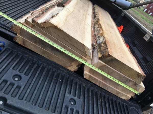

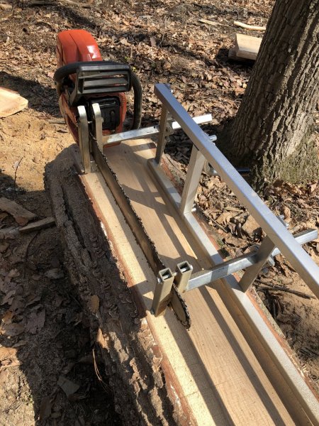

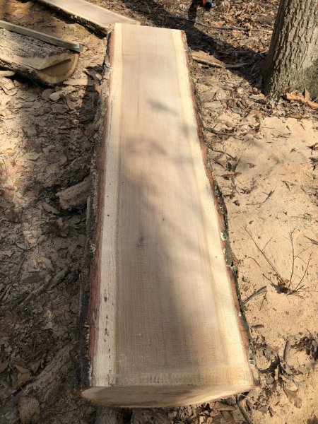

    CSMing is darn hard work. It's the absolute hardest thing you can do to a chainsaw. I've done all mine at a 40/1 ratio on the mix and a fat tune on the carb. You will find breathing the exhaust is nasty, so I've been using a strategically placed leaf blower to divert fumes. Skip sequence chain isn't required, nor is a dedicated ripping chain. I milled these oak slabs with a 28" bar with full comp, full chisel chain square filed. The full comp cut much quicker than the 42" bar with full skip. IMG_2724.JPG IMG_0090.JPG IMG_0086.JPG
