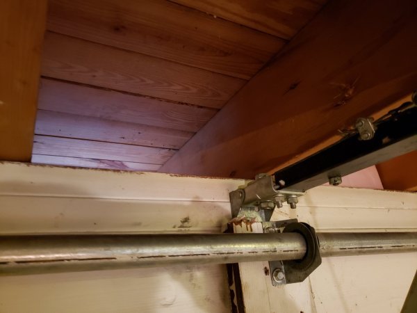

    This picture bothers me:
    Is there no ceiling there or did you just do a most excellent job of removing it ?
    Is there no insulation between the ceiling and the floor above the unheated garage ?
    That room must be ice cold in the Winter if there is none.
  6. yooperdave
    35,929
    226,089
    That's the same thing I thought when I first saw the pic. I was wondering just how couldn't he tell the bedroom wall wasn't extended out past the garage doors? But here is a pic with the ceiling still intact.
    Chazsbetterhalf and brenndatomu like this.

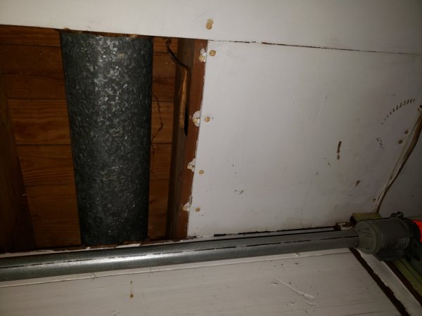

  7. ReelFaster
    ReelFaster
    Dec 1, 2016
    2,888
    20,059
    S.Jersey
    Yes it had a ceiling and while I'd like to take credit for doing a nice job of removing it, it was a pretty easy/clean removal of that exact section I needed access to because that's where joint ended, I lucked out big time. You can tell better in this picture!
    Yes, there was insulation in there and running in all the joist bays under the bedroom. Its double faced r-11 fiberglass. It was kinda of shoved loosely up in there, I don't think it was or is helping much but its there.
    Ice cold in the winter, which lead to this whole adventure. Trying to make it a bit more comfortable without going hog wild. Right thing is to pull it all down and re-do but budget constraints at the moment and like 5 other projects on tap. At least if I can stop that air flow from vented soffit will hopefully make a bit of difference.

  9. billb3
    10,513
    54,567
    Where the fiberglass insulation has turned black is where the fiberglass insulation was acting as a filter trapping the dust and dirt in the wind as it went whistling thru.
    Laying up solid foam panels in those bays outside is actually a pretty easy job.
    Best would be the spray foam but that's a rather small job to hire out.
    Solid foam, a little spray can foam to hold them in place and fill the gaps and you'll fix those ice cold floors in the room above. Nice weekend project.
    I wouldn't be surprised if the room on the back of the house had cold floors too.
    That's a HUGE heat suck.
