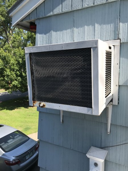

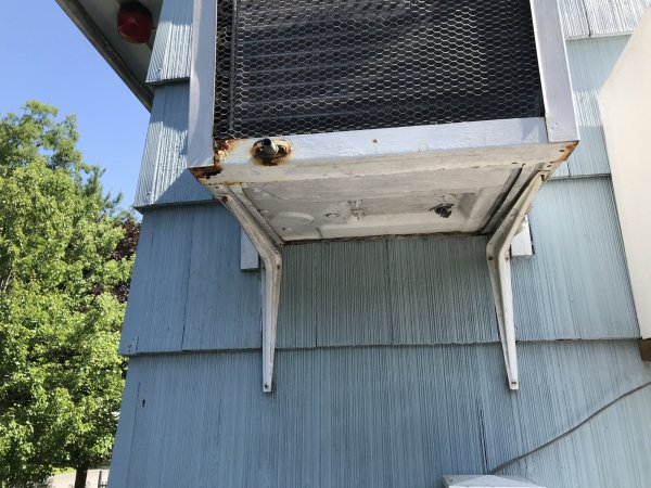

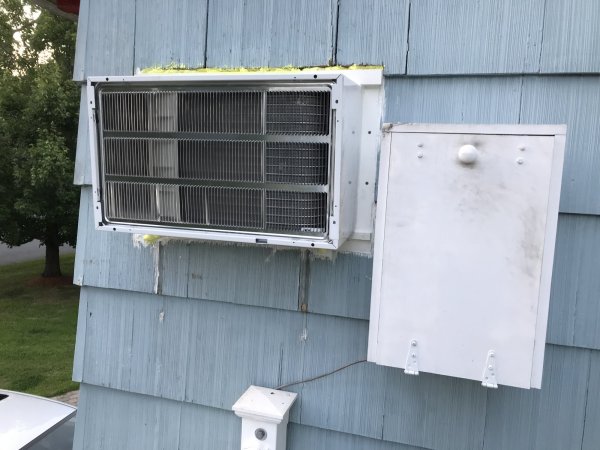

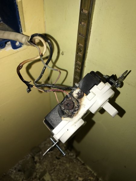

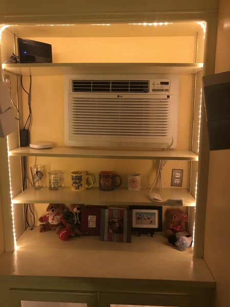

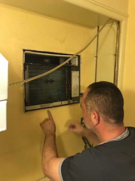

    The old unit kept tripping the breaker and finally there was a burning smell it it stopped.

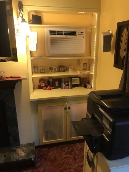

    So I got a new LG wall unit Model LT101j6CER and optional sleeve for an easy install and servicing.

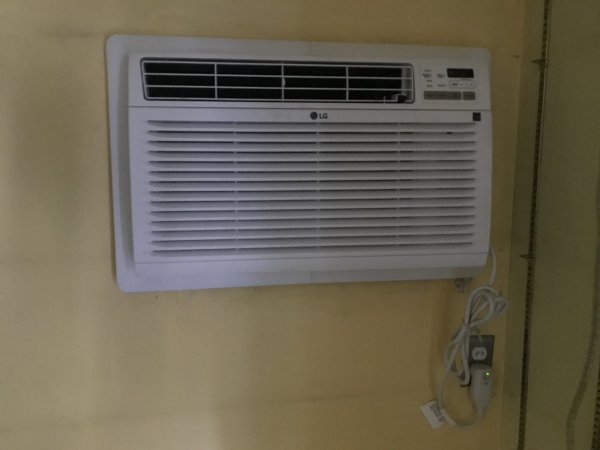

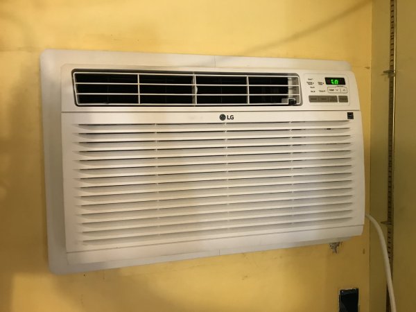

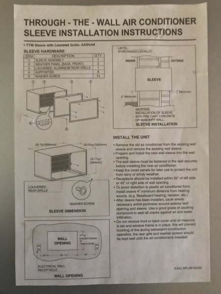

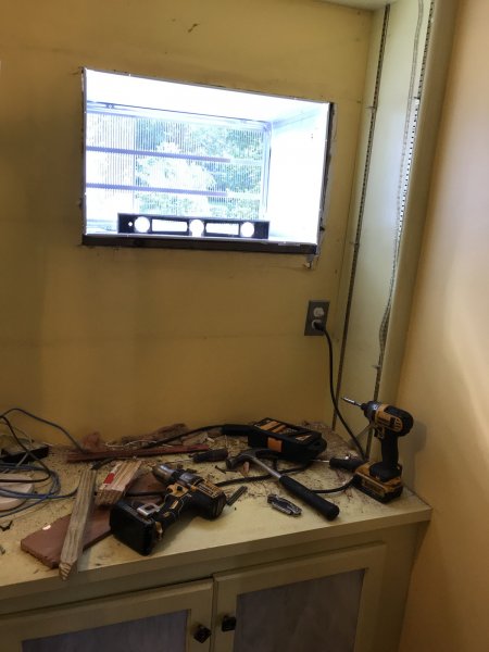

    First I do want to mention that it is a good 9,800 BTU unit but the instructions a very flawed when they say to install the sleeve flush with the wall and use the foam strips to give the unit some tilt so the water or condensation will not flow into the house! This just does not work and you must install the sleeve at an angle to make the water flow outside! I install the top of the sleeve flush with the Sheetrock and the bottom pulled out about and 1” from the Sheetrock. Also I used wood shims on the sides to keep the sides straight before screwing the sides in with round head screws and washers.
    Other than that every thing else is fine and once you get the sleeve or what I call the shell in the wall the rest is easy peasy. This is a good standard size shell 26” x 15.5” and fits many models, so should better going forward!
    Anyway this is a 120 unit to be plugged into a 15 Amp AC outlet so since the old one is burned up, I got a new one and a new circuit breaker. In the meantime, I have it on an AC heavy duty extension cord to get through the rest of this Hot as Hati heat wave!

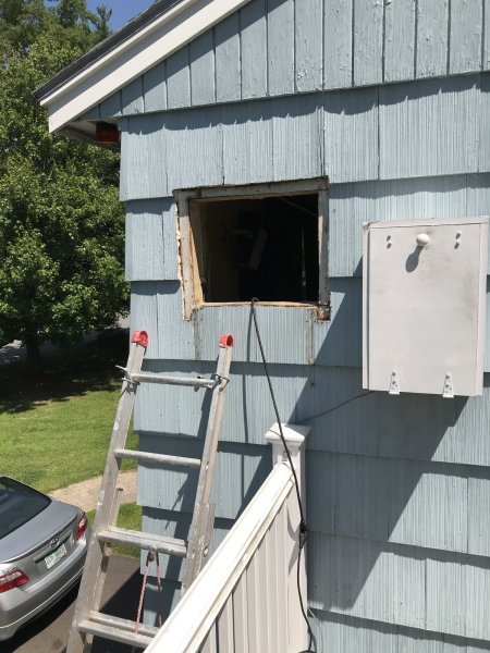

    The old unit had to shelf brackets to hold it up on the outside but the sleeve of the new unit is screwed into the wall stud on one side and a 2x4 that is screwed into the wall stud on the other side so no outside support is needed. Now I can get a custom winter cover that will slip right on the unit. :)

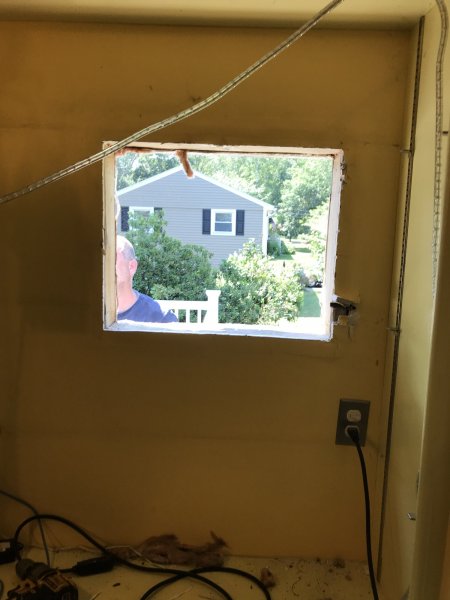

    Pic 1,2 & 3 = old AC Samsung AW1216 - Manual does not state BTUs but control panel states 12,000 BTUs
    Pic 4 = burned up AC wall outlet
    Pic 5 - 8 = widen hole of old AC unit to fit new one.
    Pic 9 - 11 = new LG AC wall unit with optional sleeve.
    4DD83B15-46AE-446C-B061-495F2EB4531A.jpeg 4C73E739-0753-4B35-92AE-D651C4C65073.jpeg 5C122584-C552-462F-8EE7-4EC99516951D.jpeg 81A28C8A-7D56-4CA1-A159-10E345BE16AE.jpeg 707FE42E-E784-4421-AD06-6056344B0573.jpeg 7DB2CF21-F986-4118-911C-ECD523DCFFE1.jpeg 63B08193-3368-4328-A5E3-79A5B82700BF.jpeg 2AEBFD08-DABE-4CB6-ADB5-1E03712F02FC.jpeg 5E08D004-6AED-4CA3-894B-E5CE6D90851D.jpeg 576A8D69-A16F-4C0E-B243-89334A23B342.jpeg

    Ummm, you lucked out on the old outlet. That could've started a fire.

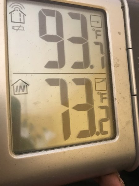

    Yes, this unit has been running all day and no water dripping out! The old one would have had water pouring out onto the walkway!
    Got it installed in the nick of time for the hottest day this year!
    93 Deg F outside
    73 Deg F inside

    This is the first time it happened to me. The old air conditioner would trip the breaker and we kept resetting it until one day we smelled smoke! Then we just stopped using it. After 25 years we knew we should get a new one, so it sat there for a long time until we had the time and money to get a new one. I knew it would be a tough job but luckily my assistant who helps me on the pellet stove jobs agreed to work with me on this, you can see him in the pics. Thankfully it took only one day to get er in. It was the second day of this 4 day heat wave and it was hot hard work but we did it! Yesterday was the hottest day this year and finally it was only 73 in the house when it was 93 outside! I was so worn out I put a heavy extension cord on the new AC unit until I fixed the outlet last night! It ran all day yesterday and no water dripping. The new units with remote control where you can set the temperature like this one are very efficient!
    It fit without moving my 100% weather proof outdoor white speaker box that I built out of Composite wood! If there is any bad weather I close the box and that way the speaker will last!

    Yes, I am lucky on the AC outlet failure. Funny thing is that we used it for the sawzall when installing the new AC unit without a problem but the new unit draws a lot more current that the sawzall so that is when I noticed the problem!

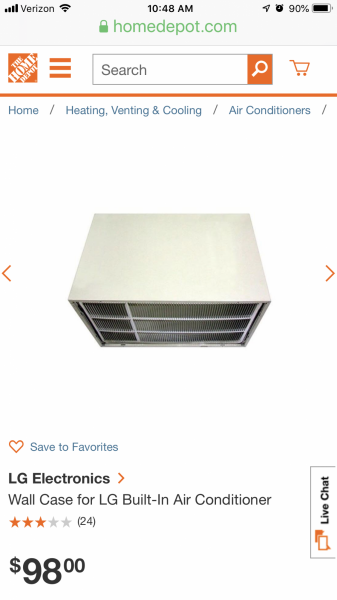

    Here are some better instructions
    http://www.hvachowto.com/2019/05/05/how-to-install-a-through-the-wall-air-conditioner-sleeve/

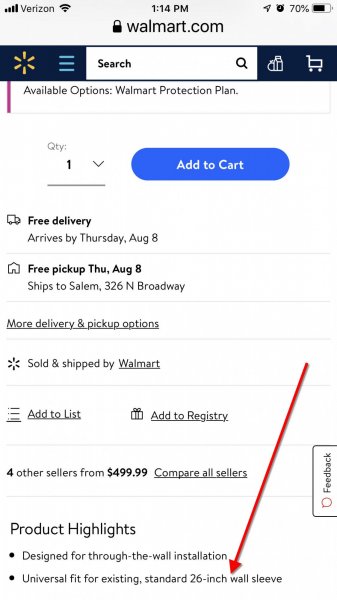

    I wanted a sleeve that was more of a standard size of that is even possible so I got the
    LG TTW Sleeve with Louvered grill: AXSVA4
    This new sleeve is 25-7/8 by 15-17/32 for the 10K BTU LT1016CER so
    Roughly 26 x 15.5
    The last pic states universal fit for a 26" sleeve for this 8K BTU LG model and the 10K & 11.5K 230 VAC LG models also fits this sleeve so that is at least 4 LG models that use the same case.
    I hope this is a little more common?
    Is that a good choice?
    https://www.homedepot.com/p/LG-Electronics-Wall-Case-for-LG-Built-In-Air-Conditioner-AXSVA4/202065340

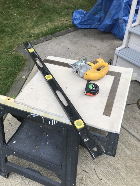

    I finally cut the 26”wide by 1” high piece of sheet rock to patch the space under the wall thru shell.
    Then it just needs wall paint.

    Hello
    Finally just finished patching and painting the wall and getting all the shelves back up!

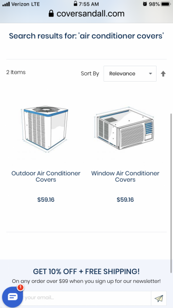

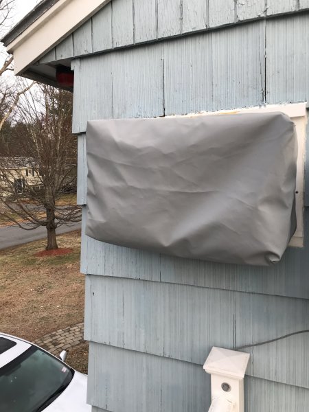

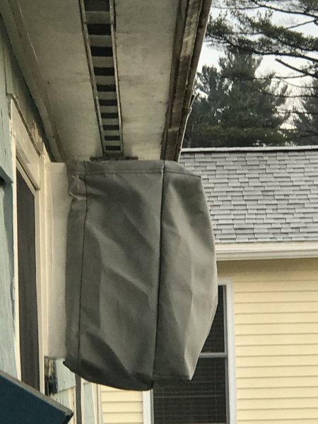

    Now to keep them ship shape and eliminate drafts in the winter, we got 3 heavy duty canvas custom fit outside covers with elastic corners from coversandall!
    Custom Covers – Patio, TVs, Fire Pits, Firewood, BBQ Grills– Coversandall
    we just uploaded a pic and outside dimensions with the order and asked for elastic corners so they just slide on and hold tight.
    Now it is cold outside but they are protected from ice and snow and cozy inside!
    See air conditioner covers here. :)
    Search results for: 'air conditioner covers'
