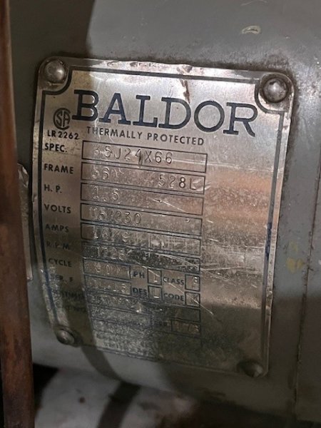

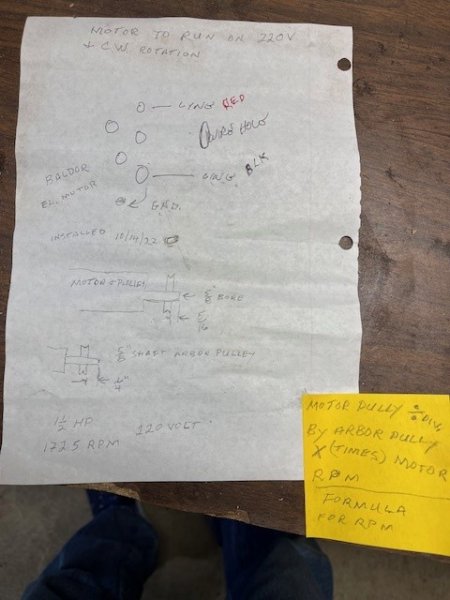

    54" belt fit perfectly. Have a dedicated 20AMP / 120V outlet in my basement for a sump pump I never put in (have a French drain). Motor starts, pump rolls over a few times and then it blows the breaker. Motor runs fine, and in reverse when not hooked up to the pump. My assumption is, on 120V it needs to pull >20AMPS (LRA) to get the pump initially moving. Looked on my panel in the basement and I do have a slot open for a 240V outlet. I'll just wire up an outlet and wire up the motor for 24oV. Screwloose will #5 and #8 stay the same for 240V or should they be put back?

    I'm not sure but I'd start with them opposite the diagram.

    There should be a tag on the motor somewhere that shows the different wiring options...might be under a cover somewhere.

    The tag is pretty faint, and next to the plate that I posted a picture of. From what I can see on the plate, #5 and #8 stay the same whether it's 120v or 240v, I'll leave them alone. You have to change some jumper wires when going from 120V -> 240V and vice versa.
    This is a motor my dad found / bought that's on it now is a different RPM than the previous motor (I'm assuming). The previous motor is on his table saw. My guess is, the previous motor was a 3400RPM motor and this is a 1725RPM motor. Based off of a calculator I found online (and the yellow note my dad attached to some notes he made for me), a 1725RPM motor * 5" motor pulley * 10" pulley on the compressor should give me 875RPMs which seems to be in the area of what the tag my dad wrote on the compressor.

    It will give a similar final rpm, but it also increases the load on the motor greatly.

    Using a smaller pulley on the motor would decrease the load on it, but it would also lower the CFM of the compressor too...which is no big deal unless you are using it for something that needs high CFM/pressure non stop.

    That's a 1 1/2 hp motor so it is no surprise it is popping a 20 amp breaker. A 4 pole 1800 rpm motor has double the torque of a 2 pole 3600 rpm one so pulley size doesn't matter as long as an equal driven speed results.
