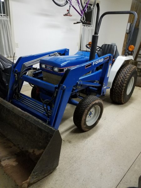

    Here's my '96/'97 Ford, She'll pull, drag, lift, load, plow, mow, and run's my splitter. 3 cyl. diesel, hydro. I'm sure a newer unit might be nice, but this little puppy has done a nice job.....
    Ford.jpg View attachment 113796
