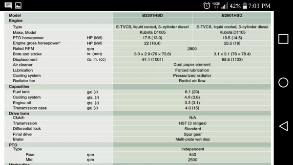

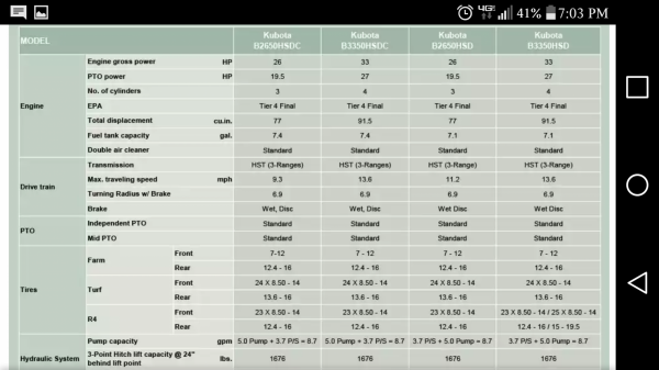

    The current B's are 2301, 2601, 2650, and 3350. The 2301 and 2601 are the same size, the 2301 loader does not lift as much. The 2650 and the 3350 are the same size, larger the then 2301 and 2601.
    The previous generation small frame B was 2320, 2620, and 2920. The larger frame B was 3200 and the B3000 (cab model). The B3200 was about $1000 less than an L3800.
    The B's also have a mid PTO where the standard L does not.
    Woodsnwoods and concretegrazer like this.

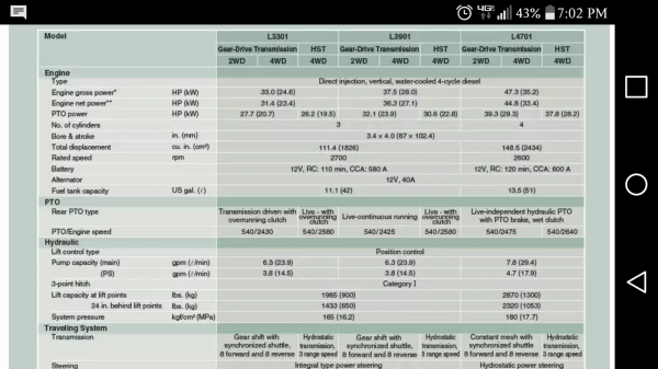

  18. concretegrazer
    concretegrazer
    4,429
    12,456
    Southwest MO
    Yes. Just look at the specs. The larger the rig the bigger the motor & stuff.

  20. 94BULLITT
    94BULLITT
    Sep 20, 2014
    2,446
    7,189
    Frederick County, VA
    The old Bs don't have position control. The new ones do.
