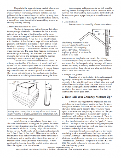

  1. HDRock
    17,249
    60,361

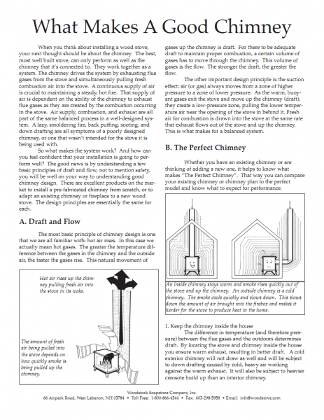

    You have to click on the little paper in the middle and down load it.
    Works on my phone
    Anyway ,here ya go :)

    Brad38 , either location should work fine. Its mostly a matter of the how much chimney/chase is visible (and some $ for chase material and maybe extra class A) vs how well the lay out works. Personally, I would go with the preferred layout. This is where you will spend your time and what's some chimney showing or a few hundred $ gonna mean in the long run. Enjoy your investment.

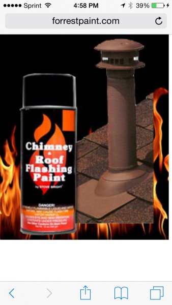

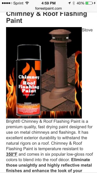

    I e-mailed Woodstock today to find out all the colors available. They use a paint supplier by the name of Forrest Paint. (Forrestpaint.com) I called and ordered color samples just to see what's out there. I've seen lots of pics of the stove online, and we're kinda digging the metallic brown with surf sand accents right now. Also, on their site, they have spray paint for chimney flues that match the most popular roof colors. Thoughts on this? Never even considered painting the chimney! Lol.

    Wondering also if this would be used on stainless?
  9. HDRock
    17,249
    60,361
    you would have to scuff everything up with some fine sandpaper or it probably would not stick,, probably would just fall right off after a while if you did not
    Brad38 and concretegrazer like this.
  10. concretegrazer
    concretegrazer
    4,429
    12,454
    Southwest MO
    I agree with HDRock you'd need to scuff to get it to stick. If your going to paint it or enclose it in a chase save some cash and get the galvanized outer wall class A.

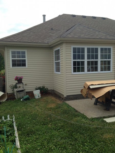

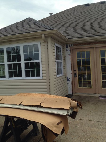

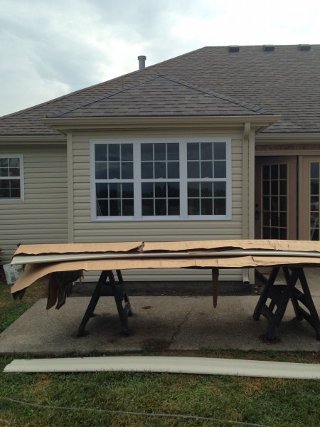

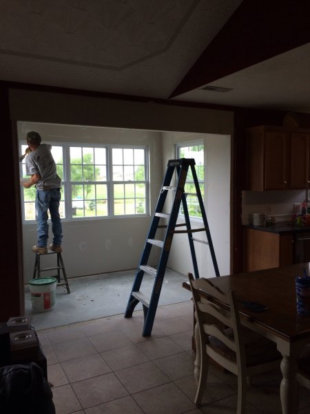

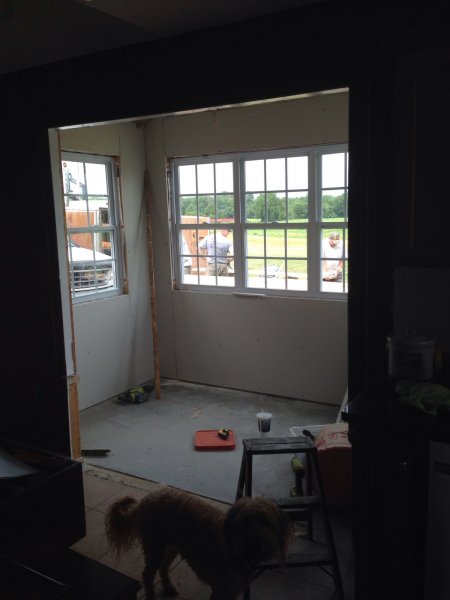

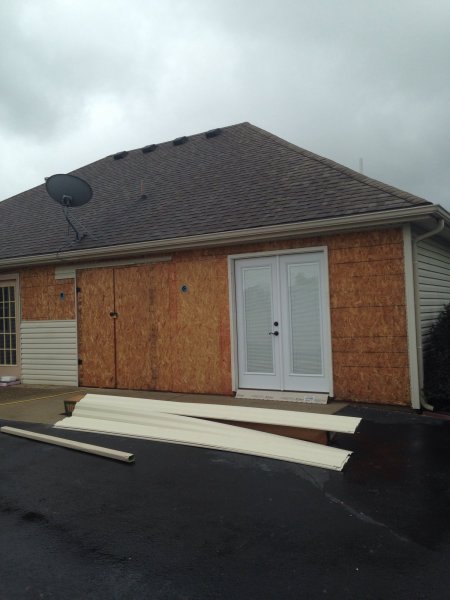

    So....my renovation has been going on for two weeks. We have the breakfast nook nearly done, and the garage conversion is well on its way. Penny from Woodstock says my Ideal Steel should be ready in early July! :dex:
    I'll post more pics tomorrow...been pretty busy.

    :thumbs: the plan is coming together
    :popcorn:
    Brad38 likes this.
  13. TurboDiesel
    16,198
    97,198
    wow! really looks nice Brad!
    I don't think we've met. Welcome to the club

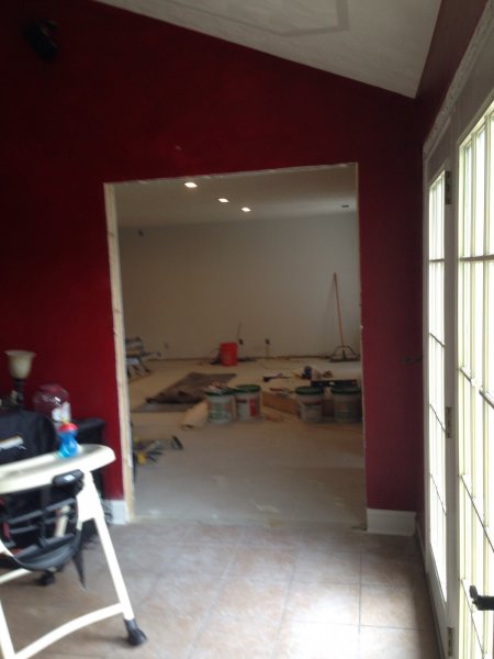

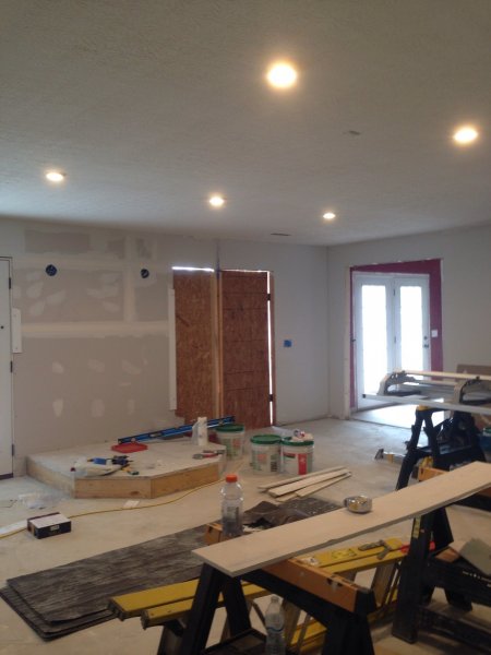

    More pics:
    New entrance cut in our existing living room: will have a barn door slider on a track to close it off if needed:

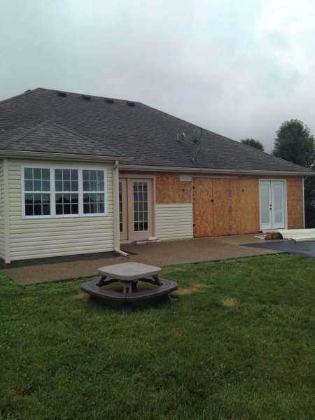

    Have another identical patio door going in on other side:

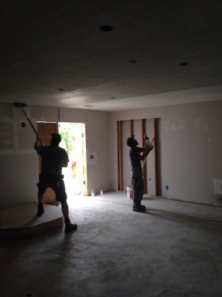

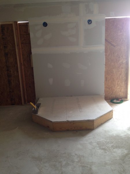

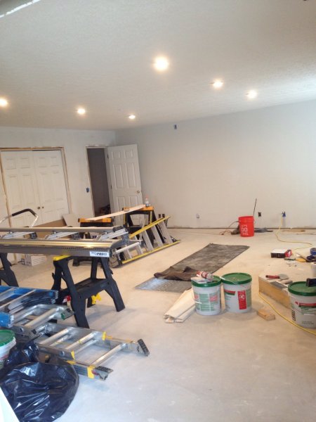

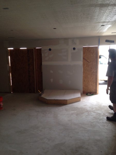

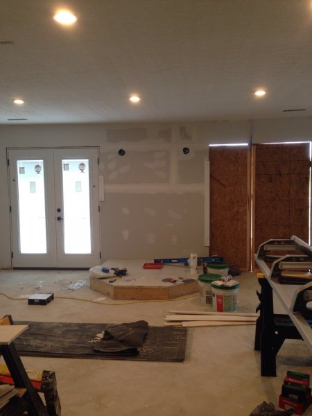

    New recessed lighting is in/w dimmer. These babies are bright!! Middle wall above hearth will be slate ledgestones. Hearth pad will be slate flagstones. Two wall sconces also. They built that hearth like a tank...lol

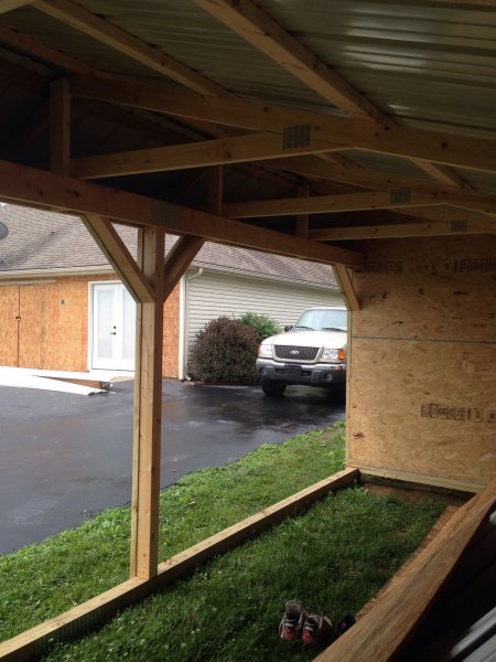

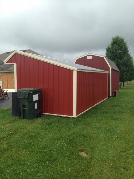

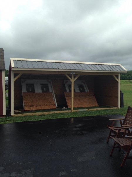

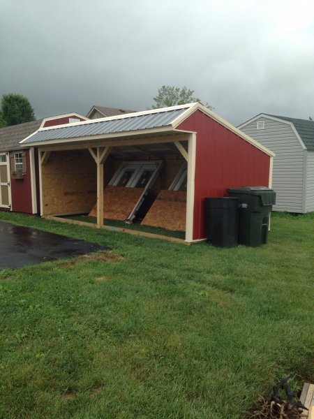

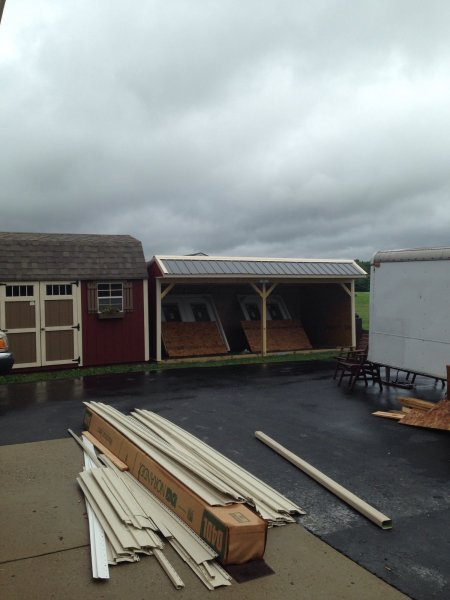

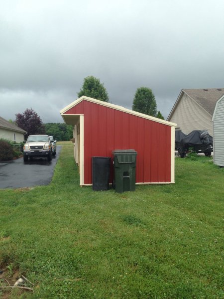

    They also dropped off my new firewood shed yesterday! It's actually advertised as a horse run-in shelter, but I thought it would be perfect for my purposes. I wish I would have taken pictures of them off-loading it. It's 9x20. They tied it down with mobile home stakes. image.jpg image.jpg image.jpg image.jpg image.jpg image.jpg
    Just waiting for seasoned wood for first year's burn :) I also asked they plywood all three sides for me. They were a great company to deal with. Still need to backfill with gravel.
