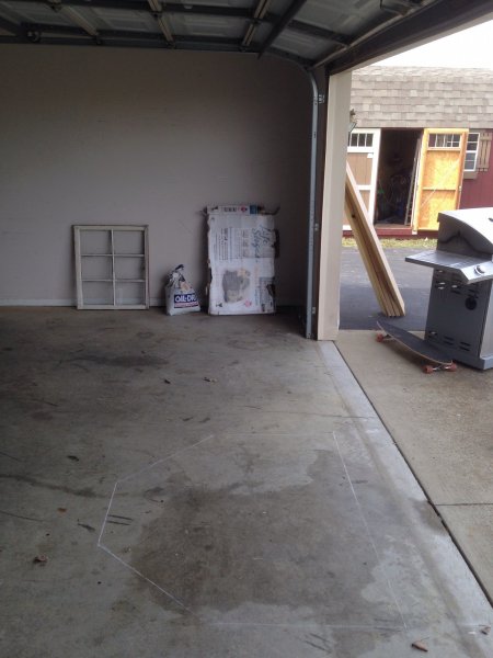

    You're not the first to call this out! It would require some re-thinking, but now that I've spent more time out there, it may be better to move it over there anyway. Tell me what you guys think!
    Please excuse my very CRUDE drawing!

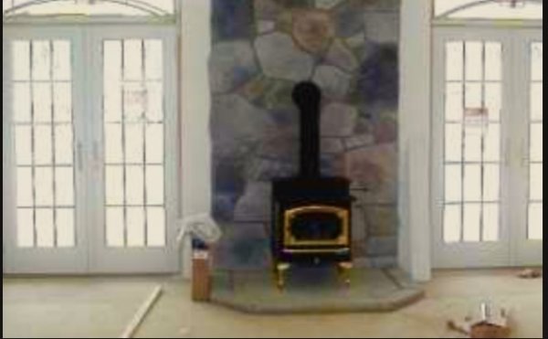

    So, the raised (6") hearth pad would be located right about here (picture 2 five-foot french exterior patio doors on both sides):

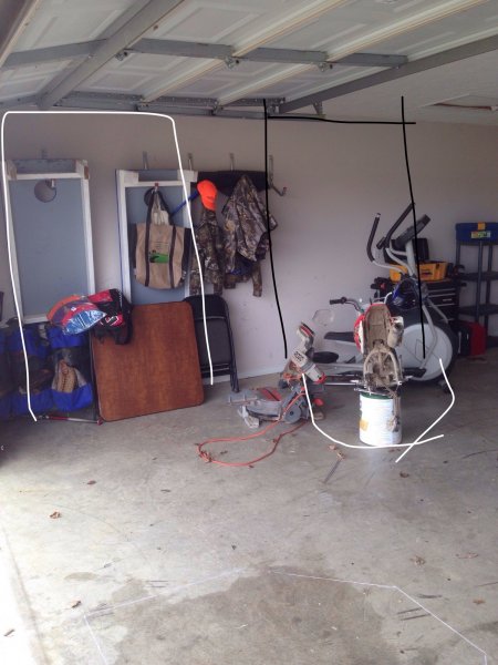

    I'm having a five-foot opening cut into the wall of our living room that will enter from the side. Here's what my view would look like walking into the finished garage. Think the hearth may be sticking out too far?

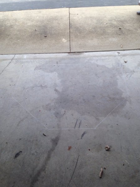

    We could move it here. I drew some more 1st-grade art for ya! The entry from our living room will be to the left (5ft opening) I could maybe locate the stove on the same wall just to the right of it. It would no longer be a room focal point, but....(you can see the chalk outline from original hearth location at bottom.)
    This is really what we're after (minus the thru-wall install), but after doing some measurements (even with close-clearance shield/pipe) end of hearth will be a good 4' into the room. Decisions indeed!:

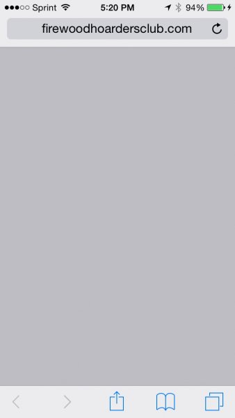

    For some reason, it's opening as a blank page for me?
  15. HDRock
    17,268
    60,522
    What , blank pdf?

    Yeah, looks like:
  17. papadave
    Do you have a PDF reader, like Adobe reader, installed? It's a good read.
    Anything you can do to keep more of the pipe inside the envelope will help all around. Close to the peak is gooder. You'll still need the same amount of Class A, as anything above the support box has to be Class A.

    Ah, you're on a "smartphone". Should be a reader available.

    My thoughts is you should not be worrying about draft. Even without a chase, it will draft just fine. Good luck. Also, no chase, be sure to brace it.

    I think it will work especially since you are going straight up with no elbows. That is probably the best way to build a chimney. If you put it at the peak and kept even more pipe inside it will be even better.
