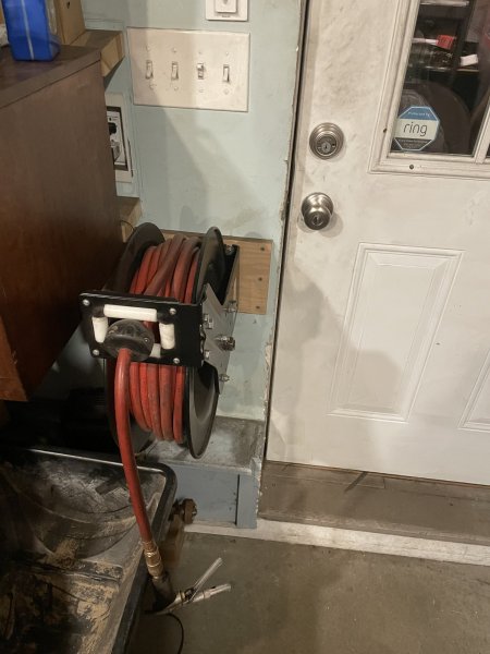

    Hi WW
    I ran a 50’ hose from the back of the shop where the compressor is to the front of the shop.
    Then I mounted a 50’ hose reel next to the door so it reaches the cars in the driveway perfectly.
    Hope this helps. :)

    Thanks Don, I ordered one and it's here ready to be wrapped :) Merry Christmas!
